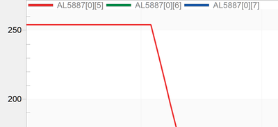

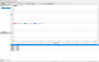

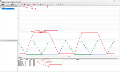

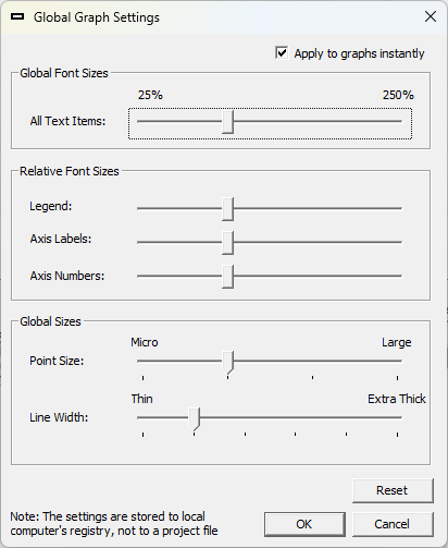

3.  When I run FreeMaster on my high resolution PC, I can see NOTHING :
For solve this issue, I adjust the DPI setting of thie program :
This DPI setting make all graphics/text message available to see.
BUT!
This cause another issue:
When I try to Export a graphics image into clipboard :
Screenshot:
Actually, ONLY export this into clipboard :
So, the rootcause , please try to fix resolution problem on FreeMaster app.

I do not realize I have seen any similar topic on this community.  The server engine did a wrong suggestion.
Anyway, there is a solution: In the Oscilloscope menu, select the "Global Graph Settings..." and in the dialog, try to increase relative size of the legend and other graph elements. You will need to experiment a bit with the values.
Michal

Dear MichalH
The  "Global Graph Settings..." already solve the font size of the oscilloscope area.
But... How about the [Variable Watch] ?

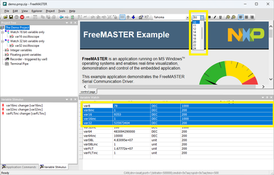

In your screenshot, it seems the font in Variable Watch is scaled properly, but the rows' heights are very small. You should be able to drag the gray row sizer at the left of the grid to resize them. Select multiple cells inside the grid and then update the size for all rows.
Also, for selected cells, the toolbar controls can control the font and size like this:
