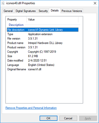

we have finally got our new ValueCAN4-2 for testing and I can confirm that the FreeMASTER  3.2.3 works well with this interface. I did a clean install of Intrepid RP1210 J2534 API Install Kit drivers downloaded from https://intrepidcs.com/products/software/vehicle-spy/vehicle-spy-evaluation/
After PC restart, the FreeMASTER can detect the IntrepidCS device and use it. Please see the information about the icsneo40.dll library as it was loaded by FreeMASTER below:

Can you give me your screenshot of the FreeMASTER plug-in configuration dialog when the "IntrepidCS" driver is selected? I'm interested in the version it prints. In my case, it is v901 (see picture below).
Also, can you display properties of the c:\Windows\SysWOW64\icsneo40.dll file and send me a screenshot of the Details tab? In my case, the DLL version is 3.9.1.31.

My screenshots:
18,957 Views
AG_92_Italy
Hi Michal,
As you requested, please find attached the screenshots you asked me. I already tried to send messages over CAN using another software (in particual I test it with Vehicle Spy) and the messages have been transmitted correctly.
