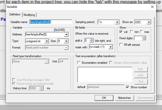

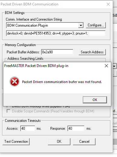

i have following Problem, i want to Setup a Freemaster Recorder with the PDBDM (Packet Driven BDM). The reason for this i need values from the controlller faster. I have used the BDM-Plugin it works with some minor flaws. But Freemaster has Problem Finding the Adress of the Packet Buffer on the MCU when using the PDBDM Plugin.

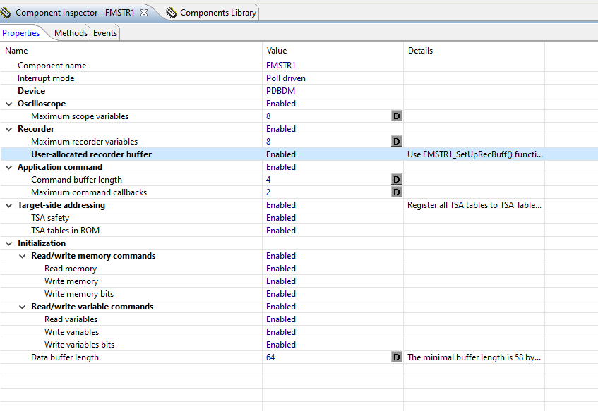

There for i have implementedwith the Procecssor Expert some Freemastercode in the Project and added the described/needed Functions running on the MCU (mine S12z).
I added following Functions in the loop.
FMSTR1_Recorder();
FMSTR1_Poll();
I also tried a Version with Setting up my Own Buffer manually not with Procecssor Expert (Configuration like in the Picture above)
When i Press the Search Adress Button, this Failure Message pops up.
FMSTR1_SetUpRecBuff(freeArraybuffer, freeArraybuffersize);
The Buffer Variable Exits

Dear Simon,
if FreeMASTER has a problem to locate the PDBDM buffer, please try to specify its address yourselves - the address can be found in a  map file. In driver v2, the buffer name was pcm_bdm_pCommBuffer (defined in freemaster_bdm.c). In the new driver, the buffer name is _pdbdm (defined in freemaster_pdbdm.c). FYI: the S12Z version of the new driver is attached to this post.
Please do not mix the PDBDM buffer which is used for general communication with the recorder buffer. Once you establish the communication between FreeMASTER and the target MCU, the recorder should work well (the Poll and Recorder calls in your main loop should be enough). You may leave the recorder buffer to be allocated automatically, just specify its size.
I do not know the ProcessorExpert wrapper around the FreeMASTER driver well enough, so if you are still in trouble, I will try to look for some help internally. Or you may try the new driver without PE.

But i could find the error. For me it worked to deinstall all drivers of Freemaster and Freemaster an installed. Restart PC. Then i installed the Freemaster Version 2.0 and the right driver (Verseion 2.0 ). (Seems that PE use the old Variable names for the Buffer so check if driver an PE variables match). Restarted my PC! And i was able to establish a connecetion and read some Data.

Update: it works just fine now .... the mapfile didn't reload but with fresh mapfile it works

I tried with Freemaster Version 3.0 and 2.0 then i realised they share drivers i deinstalled both, when i realised after you post the PE only generates the old Variables which the old driver searches for. And i think Freemaster 3.0 searches for the name of the new ones so, my Idea for fastest fix was just to patch down, so that the Freemaster and PE Variables matches. Maybe its cause my Version of CodeWarrior 11.00
