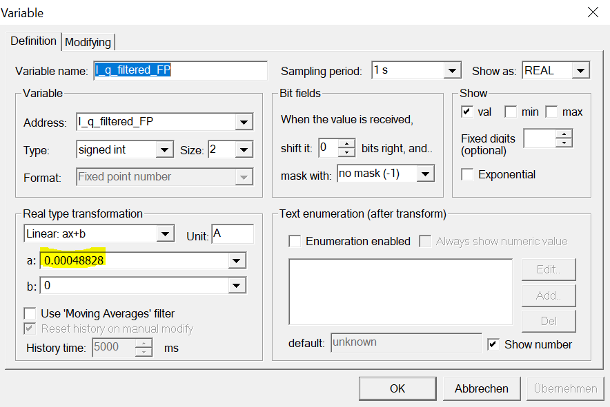

Hi All,
I want to show variables in FreeMaster as REAL values and Im wondering if it is possible to define the factor as project global constant.
In my example I would like to write ScaleCurrent instead of 0.00048828.
And somewhere else ScaleCurrent = 0.00048828.
Is this possible? What is the best way to do this?
Many Thanks in advance
Sami

Dear Sami,
you can store the parameter in the target MCU application as a value of a constant variable. Then you may define a FreeMASTER variable to access that value - set its Sampling Period to "once" as it is constant anyway. Then you may use that variable as a parameter in REAL value transformation of other FreeMASTER variables.
Michal
