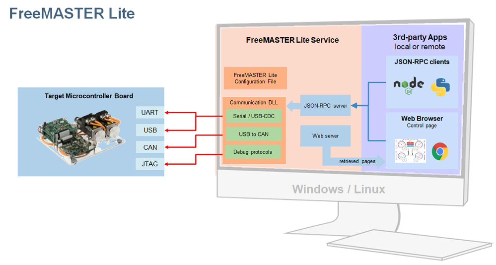

A new feature – called FreeMASTER Lite – composed of a the FreeMASTER communication core library and the web-server running on the host is now available for Windows and Linux operating systems facilitating connection to the target microcontroller application from any web browser. JavaScript or Python scripting to control the target is now also available via FreeMASTER Lite.

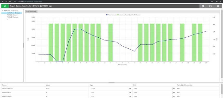

Chromium browser and JSON-RPC API
While Internet Explorer and ActiveX scripting interface is still supported, the new Chromium rendering engine is now available thanks to the CEF project. All ActiveX methods are now also accessible using fully asynchronous JSON-RPC API. Control pages and JavaScript can now be debugged in a standalone Chrome browser.

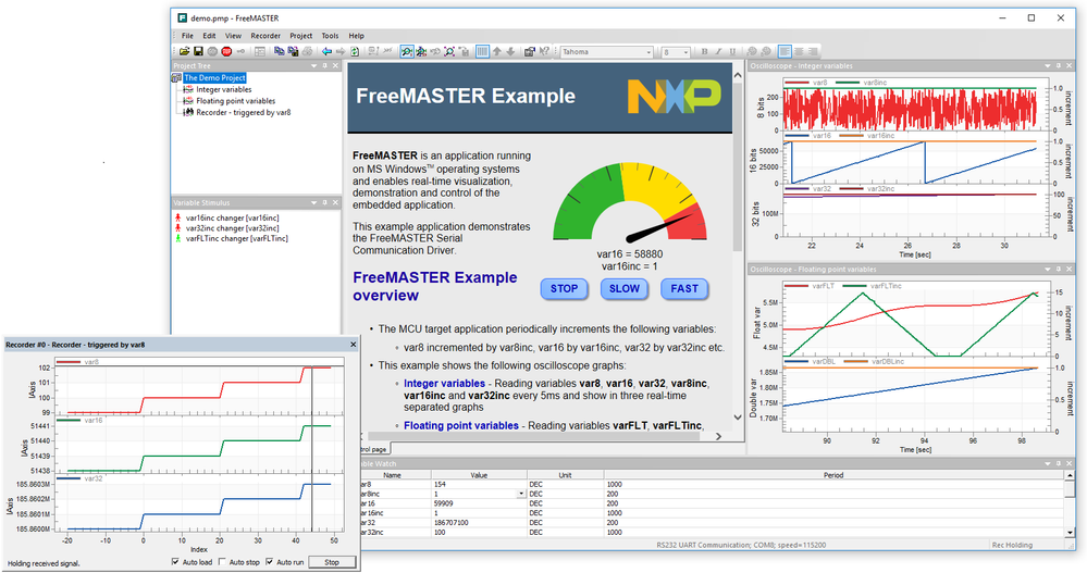

Multiple Recorder, Oscilloscope and Pipe Views
Graph and Pipe views may now be open as floating windows or docked to a side of the main application window. Simply right-click an Oscilloscope, Recorder or Pipe item in the project tree and select "New Window...".
Enhanced Data Capture
Multiple graph and pipe views can now be configured to capture data to files simultaneously. Oscilloscopes may also be configured to capture only unique values, skipping redundant consecutive samples.

FreeMASTER "Lite" Service
Brand new FreeMASTER "Lite" Service may be started on a host computer to provide a JSON-RPC API to remote clients. Such clients are typically control pages running on remote devices (tablets, phones) or test scripts written in node.js, Python and others. Using the "Lite" service, you can exploit FreeMASTER functionality on Windows or Linux platform without running the "full-weight" FreeMASTER UI application.
The JSON-RPC interface implemented by the service is almost identical to that provided by the standard FreeMASTER desktop tool and to its ActiveX interface. Unlike the full FreeMASTER application though, the Lite service does not have a user interface. It is configured by a local configuration file and runs silently on the user computer. The control pages and other clients (like script applications written in node.js or Python) may connect to the service from local or remote computers and access the target microcontroller application. The major difference from the desktop FreeMASTER application is that the Lite service also acts as a standard web server and may provide control pages and their resources to remote clients like tablets or mobile phones.
