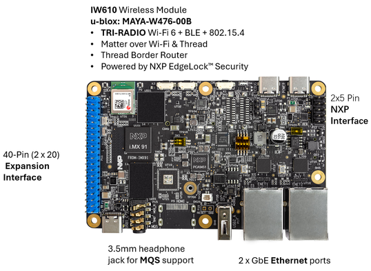

FRDM-IMX91 Hardware Introduction
The FRDM i.MX 91 development board is a low-cost and compact development board with NXP i.MX91 applications processor. On-board NXP IW610 Tri-Radio module supports Wi-Fi 6 + Bluetooth Low Energy 5.4 + 802.15.4. NXP releases Debian every six months and releases Yocto every year for this board. The FRDM i.MX 91 development board is ideal for developing modern Industrial and IoT applications.
Get to know FRDM-IMX 91 Development Board
Specifications:
    • 1x Arm® Cortex®-A55​
    • MAYA-W476-00B, Wi-Fi + BLE 5.4 + 802.15.4​​ Module on-board, IW610
    • 2x GbE Ethernet (1xETER, 1xTSN)
    • M.2 Key-E for Wi-Fi/BLE/802.15.4​
    • LPDDR4 16-bit 1GB
    • eMMC 5.1, 8GB
    • MicroSD 3.0 card slot
    • 3x USB 2.0 Type-C connector (1-Debug, 1-PD, 1-USB2.0) + One USB 2.0 Type-A​
    • 40 pin (2x20) Expansion I/O
    • One 2x5 Pin NXP interface (1- CAN, Two channels for ADC, I2C/I3C expansion)
