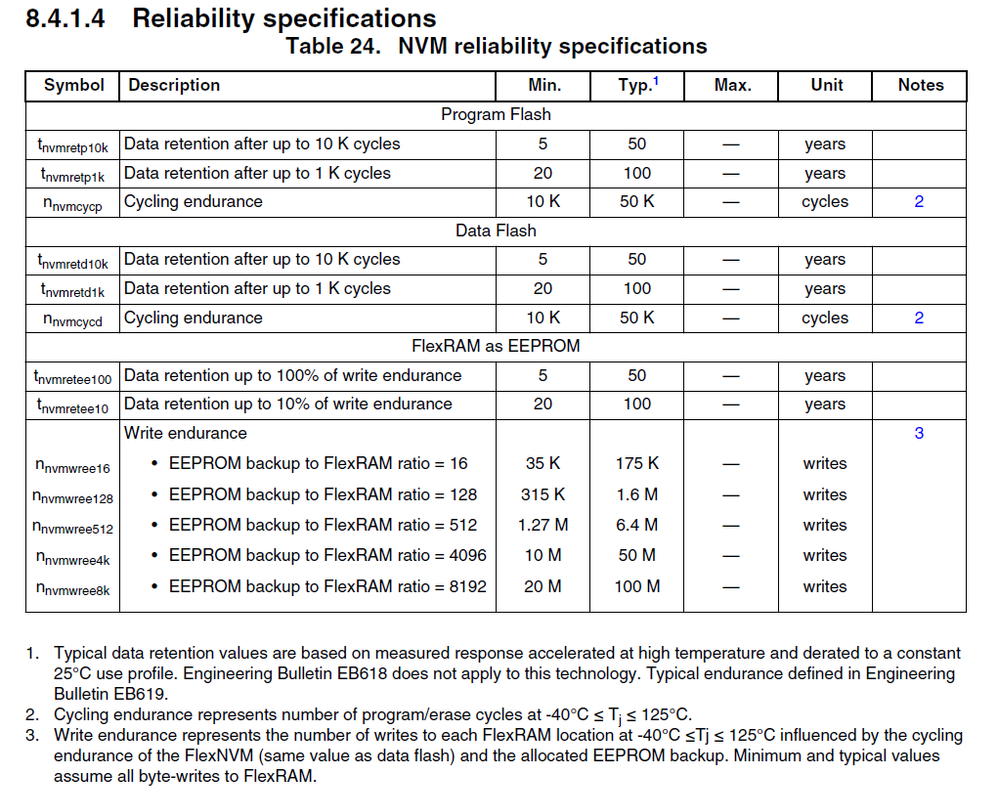

What is the  write endurance for the MC56F847XX Program Flash? Is it 10K cycles? Is there any register that could read on the no. of write cycles. Thanks.

xiangjun_rong
HI,
The minimum cycles of erasing and programming for MC56F847xx flash is 10K, the maximum is 50K.
I copy the specs from the data sheets:
Hope it can help you.
