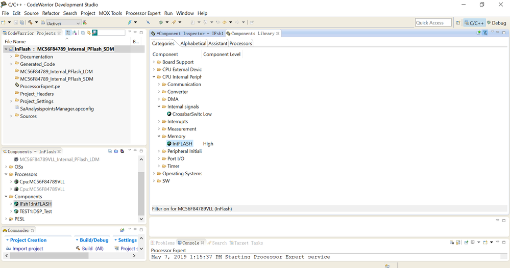

xiangjun_rong
Hi, Jolanta,
Regarding your question, we have the processor Expert(PE), the PE has intFLASH bean, with which you can erase both Program/data Flash, program Program/Data Flash.
This is the bean:
In the IntFLASH bean, you can select data Flash as Following:
I attach an example for MC56F84789  which is based on CodeWarrior for mcu ver11 tools can erase/program program flash, it tell you how to call the erasing function and program function. You can select the data flash and program it based on the erase/program function with different address and size.
Hope it can help you
