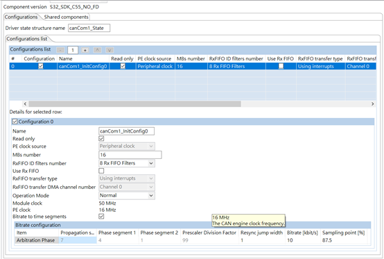

I have a problem about CAN_TX in MPC5746R.
I wanted to send a sample date but i can't get right date in Oscilloscope.
I didn't know what's wrong. Can someone give me a hand ? thank you very much.
There are my code . Any suggestion is helpful.

FLEXCAN_DRV_Init(INST_CANCOM1, &canCom1_State, &canCom1_InitConfig0);
FLEXCAN_DRV_Init(INST_CANCOM2, &canCom2_State, &canCom2_InitConfig0);
flexcan_data_info_t dataInfo =
.data_length = 1UL,
.msg_id_type = FLEXCAN_MSG_ID_STD
/* Configure TX message buffer with index TX_MSG_ID1 and TX_MAILBOX*/
FLEXCAN_DRV_ConfigTxMb(INST_CANCOM1, TX_MAILBOX, &dataInfo, TX_MSG_ID1);
FLEXCAN_DRV_ConfigTxMb(INST_CANCOM2, TX_MAILBOX, &dataInfo, TX_MSG_ID2);
while(1)
TX_date[0] = 0x11U;
/* Execute send non-blocking */
FLEXCAN_DRV_Send(INST_CANCOM1, TX_MAILBOX, &dataInfo, TX_MSG_ID1, (uint8_t*)TX_date);
0 Replies
