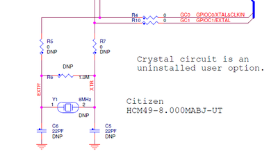

Hello all,
I am having some difficulties while searching specific information about the input capacitance of the following 56F82746VLF pins (LQFP-48):
- pin 3, configured as CLKIN0
- pin 4, configured as GPIOC1
Can anyone help me?
Thanks,  Matteo

xiangjun_rong
Hi, Matteo,
I am not clear about your question. Anyway, as you know that the MC56F82746 can connect to crystal and clock source. The crystal component is a passive, it has two pins, you can connect the crystal to the Xtal(pin4) and EXTAL(pin3) together two 22pF capacitors and one 1Mohm parallel resistor(optional) as the followng fig.
For the crystal, there is internal oscillator for the MC56F827xx so that a clock signal can be generated.
If you connect a clock source which is active device(it has independent power system can output clock signal), you can connect the clock signal to CLKIN0(pin3) directly, no capacitor is required in the case.
Hope it can help you
XiangJun Rong

matteomagistra
Hi Xiangjun,
thanks for the reply, There is no additional external capacitor.
We have a batch of pcbs with pin 3 and pin 4 connected together (cannot delete connection).
Pin 3 is set as CLKIN0
Pin 4 is set as GPIOC1
My question is:
(Internal input capacitance of pin3 + Internal input capacitance of pin4) <= 15pF?
Best regards, Matteo
4,675 Views
xiangjun_rong
Hi, Matteo,
Now I see your issue, you connect the pin3&4 together by mistake on PCB.
Generally, the pin parasitic capacitance is 1~2pF, so there is not any problem if you connect pin3&4 together.
In default, the pin4 is in GPIO input mode, it is okay. Do not configure it as GPIO output mode or XTAL mode.
XiangJun Rong
