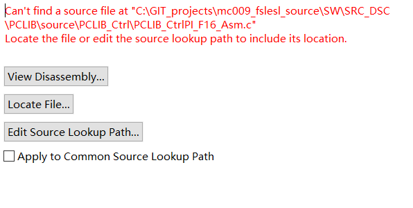

Add FSLESL in MC56F82748 project .
Can't find a source file 'PCLIB_CtrlPI_F16_Asm.c' (FSLESL only has PCLIB_CtrlPI_F16_Asm.h).
What should I do to find a source file 'PCLIB_CtrlPI_F16_Asm.c' ?
 The picture:
1,378 Views
xiangjun_rong
Hi, Zhang,
In order to protect NXP IP, now for the RTCESL package, we only provide the library instead of source code.
The *.h files include the api function prototype so that you can know the function format.
sorry for not helping you
