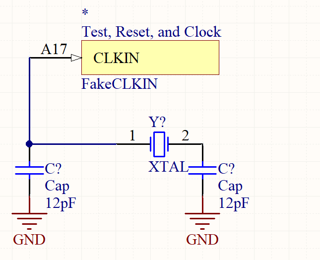

I'm trying to hook up a crystal to the MCF5484.
There's a CLKIN line where it looks like the crystal hooks up to.  Usually there's like a CLKOUT or osc_out, xtal_out or something but I'm not seeing that.
This is what I have so far:
Am I missing something?
Thanks in advance
Zach

TomE
Specialist II
The Data Sheet has a section on the PLL detailing the CLKIN signal in "Table 7. Clock Timing Specifications". The levels and rise time can only be obeyed with an external hybrid oscillator, not a crystal.
In the Reference Manual:
10.1.2  Clocking Overview
The MCF548x requires a clock generated externally to be input to the CLKIN signal.
Tom

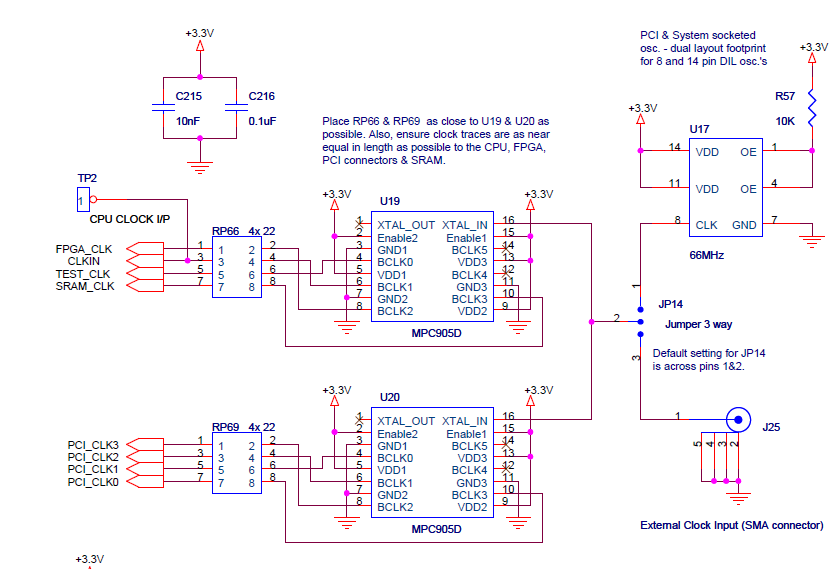

miduo
Actually the M5485EVB is not designed by NXP(Freescale). It was developed by LogicPD. However we had an internal evaluation board which was for internal test. The above schematic is from this board.

zwilcox
Ahh ok.  Cool thanks.   I'll need to fix this.  That helps.

miduo
Please see our evaluation board for the clock scheme:

zwilcox
Hey miduo‌!
Would you be able to provide the schematic for the eval board?
I don't see it listed here MCF5485 Evaluation Board|NXP
