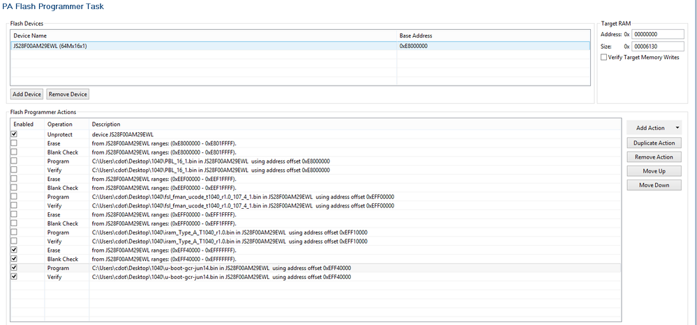

   In my custom board using processor T1040 . When i am trying to program the Uboot.bin into NOR flash , after programming few location it is showing error. I am able to fuse .pbl and iram files but not uboot.bin file.
check the below log file and error i am getting..

cmdwin::fl::image -f "C:\\Users\\cdot\\Desktop\\1040\\u-boot-gcr-jun14.bin" -t "Auto Detect" -re off -oe on -o 0xeff40000
cmdwin::fl::write
Programming file C:\Users\cdot\Desktop\1040\u-boot-gcr-jun14.bin

suggest the solution for debugging this issue.
and check my NOR flash settings in below screenshot.. I checked by increasing the Target RAM size also.

yipingwang
Hello suresh kalepu,
I suspect there is problem with DDR controller initialization or the DDR is not stable.
I suggest you use SRAM initialization file (CPC as SRAM).
When you create a bare board project, please select Downlaod/Connect SRAM launch configuration, and use it to connect to the target board and execute flash programming tasks.
Yiping

sureshk
Hi Yiping,
       I set the JTAG clk speed in CW to 1000kHz and able to fuse the NOR flash without errors. I thing JTAG clk speed is the issue.

sureshk
Hi Adrian,
       I am erasing the sectors before programming..You can check the same in screenshot..
Thank you.
