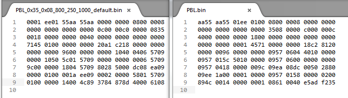

Hello , I'm Nattapong.
I'm working on LS1012ARDB and try to use GPIO1_xx and GPIO2_xx.
As i found on community, I have to change value at RCW.
I imported RCW file and adjust SDHC1_VSEL to GPIO1[23].
After generated PBL binary file looks like i got big endian if compare with original file.
[Left is original file, Right is change SDHC1_VSEL to GPIO1[23]]
Can I select endianness for output?.
Thank you

addiyi
Use the drop down selection and select Quad SPI.

addiyi
Which version of QCVS you are using? If you use the latest available version, just select the RCW Sources as Quad SPI and PBL_swapped.bin will be generated.

nattapongsungch
Yes, I'm using latest  version (Version: 11.2.1 Build Id: 160913).
How can i select RCW source ?.

addiyi
