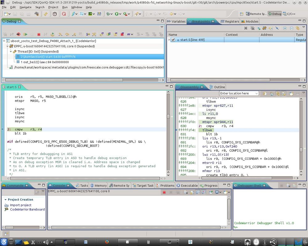

Hello everyone,
Hope my question among common one.
I build u-boot.bin u-boot (elf file) by
=> version
U-Boot 2013.01QorIQ-SDK-V1.5 (Dec 11 2014 - 11:19:47)
powerpc-fsl_networking-linux-gcc (GCC) 4.7.3
GNU ld (GNU Binutils) 2.23.1.20121113
and start it debugging as said in "Code Warrior U-Boot Debugging" (Document Number AN4876).
After reset i able to step code in start.S.
I know little about assembler of PowerPC CPU, but suppose that things in disassembler window is far not the same as in source_code window.
Below a screen shot of this windows.

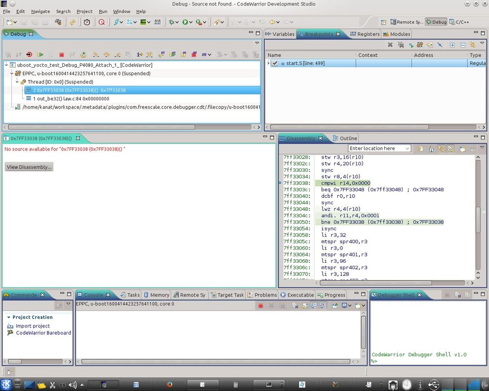

After transiting into Stage-2 (after sti instruction) CW says that "Source not found" and run into Endless Loop when stepping more.
See here a picture:
What is wrong in this case?

The u-boot debugging process depends on the core you have on your board.
Since you are using 4080, your core is e500mc. In the app note that you are reading from
there are various sections corresponding to different cores. For start, please make sure that
you are following the correct section - in your case "Debugging U-Boot from NOR for e500mc".

Ok. I found that in Reset dialog should use /opt/Freescale/CodeWarrior_PA_10.3/PA/PA_Support/Initialization_Files/QorIQ_P4/P4080DS_uboot_36.tcl  initialization script (same as in Target's). Instead of P4080DS_init_core.tcl.
Now i see source code and disassembler window in sync with each other.

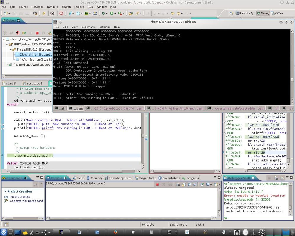

Hello, EveryOne!
I am getting more familiar with CodeWarrior 10.3
Now can debug u-boot at all 4-stages.
And now i want to do my job faster.
I read from  Document Number: AN4876
Similarly, you can go straight to board_init_f breakpoint:
1. reset hard
2. %>bp –hw board_init_f: Assuming that this breakpoint is not yet enabled in your
Breakpoints view.
3. %>setpicloadaddr reset: For a NOR flash setup, board_init_f runs in the address
range to which U-Boot was linked to. So, reset is ok.
4. %>go: It runs through all the various memory map changes and stops on board_init_f
breakpoint in NOR.
But i see:
Error: unable to resolve location
If the AN4876 document is obsolete now?
Or maybe i must load symbol table by hand?
I found command "help" in Debugger Console, it is encouraging, but maybe here some recent documents to read.
