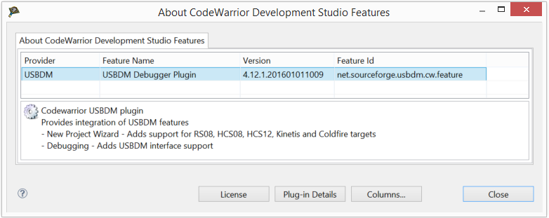

bonjour
j'ai fabriqué un programmateur usbdm
et installé usbdm version: 4.12.1.40
CodeWarrior for MCU
     Version: 10.6
     Build Id:140329
impossible de voir le device sous code warrior :
choix usbdm non présent lors de la création d'un nouveau projet.
merci de votre aide

Hi Thierry,
Could I check:
  • Did you install USBDM after Codewarrior?
  • Is Codewarrior detected by the installer (it should appear selected)?
  • Does USBDM appear in the about Codewarrior dialogue?
  • If you click on the icon it should produce more information:
I confirmed that I was able to create a project for the MC9S08QD4 device with a USBDM launch configuration.
It is necessary to install USBDM after Codewarrior (and possibly re-install after a major update) as USBDM modifies the Codewarrior installation.

Hello Thierry
What is the part number of your MCU?
Best Regards
Fiona Kuang
Technical Information & Commercial Support
2,154 Views
bourineauthierr
The part as target is  s9s08QD4
The part usbdm is s9s08js16CWJ
I checked each connection of the PCB ..I
Code warrior is a special edition.
I will deinstall and reinstall code warrior  and to check again
Thank
