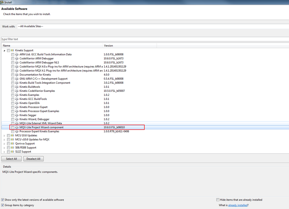

Hello HW,
Please check have you install the "MQX-LITE wizard component" here :
Hope it helps

huang_hw
After installing, I do get the MQX-Lite Project when I do a File->New to create new project.
However, if I choose MQX-Lite Project by clicking it, nothing happens. (not even an error message).
(Could be something else which I need to install)

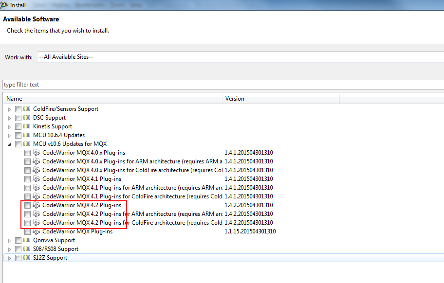

Hello
Have you install the MQX4.2 ?

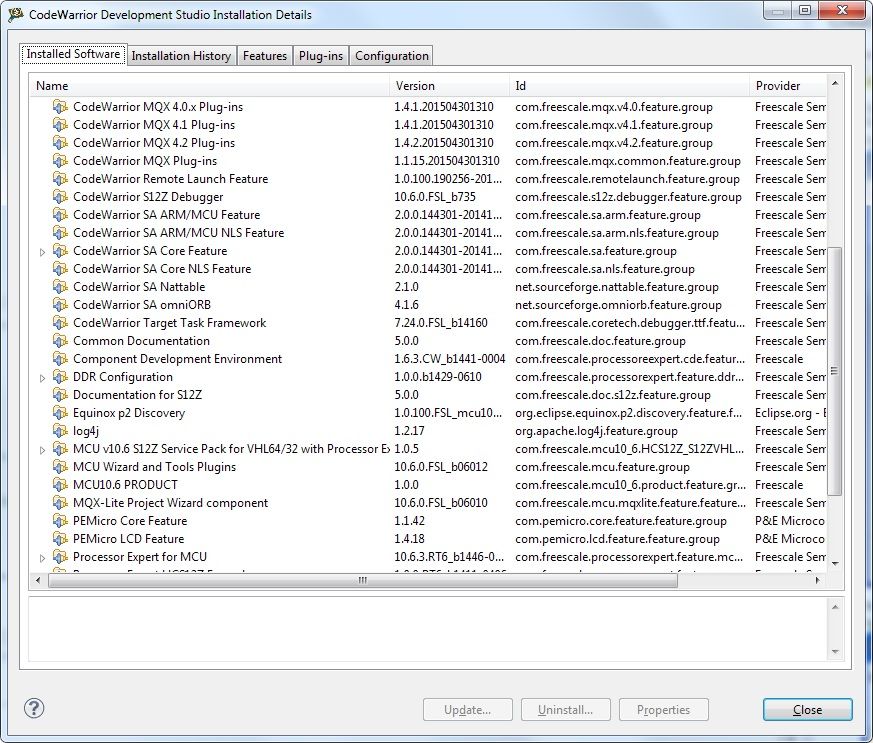

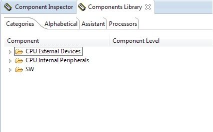

Sorry if I sound like I am asking the obvious; what else must I do to be able to add MQX Lite to new or existing projects?
After installing CodeWarrior MQX 4.2 Plug-ins, I still have
a) No respond when I choose to create a new project and then choose MQX Lite.
a) Do not have the category OS when I try to add MQX Lite to an existing project.
(see diagram below)
I already have MQX Plug-ins, MQX 4.0.x Plug-ins, MQX 4.1 Plug-ins, MQX 4.2 Plug-ins and MQX-Lite Project Wizard component all installed when I experience the symptoms described above. See the screen-dump showing the relevant areas of the "Installed Software".
