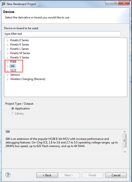

Hi everyone and happy new year!
I want to use 8/16 bit mcu but no clue which codewarrior to use.
I went to page 8/16 bit MCUs|NXP but it seems there are some instances of codewarrior under design resources>software and tools
Could someone clarify the differences between them?
thanks

Hello ,
What about the part number of your chip ?
- For the 16 bit chips , you can use the CW5.2, it includes this chips :
you can download it on here :
CodeWarrior Dev Tools for HCS12(X) MCUs|NXP
- For the 8 bit chips , you can use the cw10.6.5(cw10.6.4 with update 5) , it inculdes RS08 and S08 series chips , it also includes S12Z chips.
you can download it here :
CodeWarrior Development Tools Suite - Special|NXP
Alice Yang
