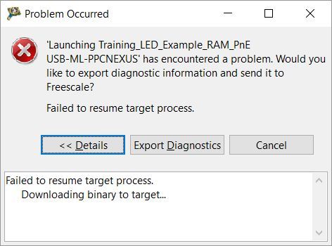

When building the example project (in RAM configuration) the following error comes-up: Cannot open file crt0_include.inc although the file exists and is located at the same path as the other project files. If building in FLASH configuration there is no compile error but the debug process fails with an error: Failed to resume target process.

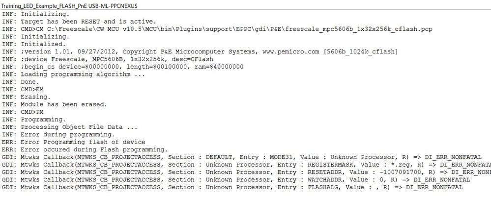

After further digging around I managed to find the problem and the solution:
It seems that CW cannot distinguish between MPC560xB and MPC560xBK and wants to use the same flashing algorithm (the one for MPC5606xB ) for both, which is wrong. The micro on the  TRK-5606xB rev.D seems to be the MPC5606BK which needs a different flashing algorithm. A more detailed explanation of the problem and solution can be found here: Error message: flash programming error when programming MPC560xBK (TRK-MPC5606B) in CodeWarrior for ...

- managed to grab a print screen of the console (for some reason it is cleared immediately when the  error message appears and I missed some messages):

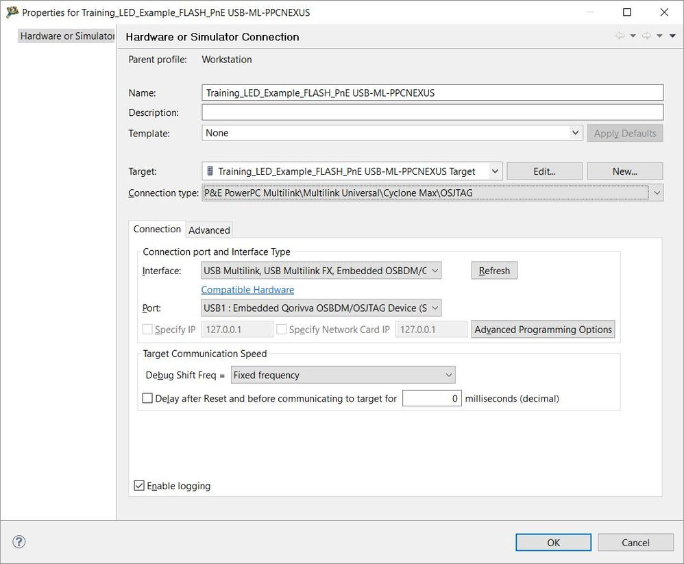

- found a thread which is dedicated to the same problem I have:Error: Failed to resume target process. Downloading binary to target... in which you responded. My target and debug configurations are as described in this thread with only one exception, the "Target communication speed" field. I do not have multiple options in the "Debug Shift Freq field". I have tried to change the "delay after reset" settings as in the other thread but the result was the same.
- the target is set to MPC5606B and this the the micro on my kit board.
- the board image posted by you in the other thread has the exact same jumper settings as mine

Unfortunately, the target debugging process is still failing also for the RAM build configuration. I am getting the same message for both FLASH and RAM:
I can see from the information displayed in the console and status bar that the connection between the target and PC is ok and that downloading is successful. However, when trying to launch the app. I tried different target power supply settings (USB and external supply) but with the same result. What else could be wrong or what is missing for making it run? I am new to the Eclipse-based CodeWarrior so I might be missing some project settings.
