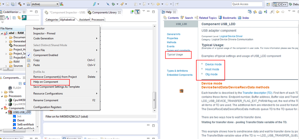

I am using a customized board with MK50DX256.
I want to use processor expert in CodeWarrior to use it as a device driver. I want to be able to use the serial function in hyperterminal through USB. Is there a bean in processor expert that would help me achieve that? Also any sample project would help?
18 Replies
28,306 Views

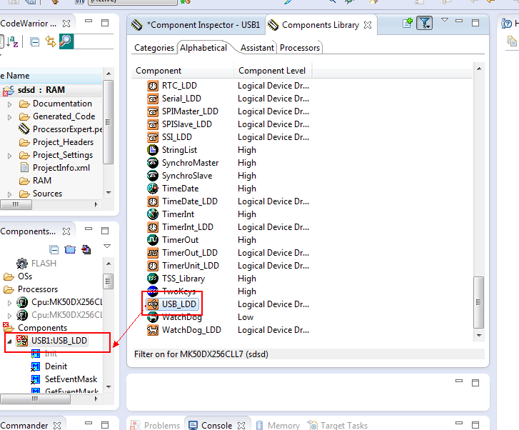

Hello Kiran,
You can use the component of  "USB_LDD".
After add this component , right click it , then select the  "help on component " , then click "Typical Usage",
there is USB demo :
Hope it helps
Alice

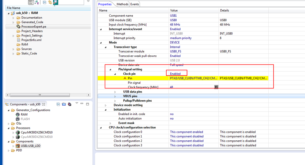

kirantujare
Hi Alice,
Thank you for the reply. I have the following error.
Can you help me figure it out?
28,295 Views
Hello Kiran,
I think you have not enable the "clock pin":
Hope it helps
Alice

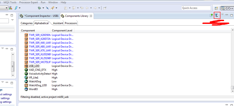

kirantujare
Hi ALice,
I installed USB Stack v4.1.1 NXP bare metal (no OS) USB Stack and imported USB_.PEupd components in the processor expert but I cannot view USB_AUDIO_CLASS.PEupd and USB_CDC_CLASS.PEupd because the processor expert filters these components. Is there a way to remove the filter. I have pointed out the place where it is filtered in the attached file
28,294 Views
Hello Kiran,
1) You can disable the filtering :
2) If you use the PE component , there is demo code on the "help on component " i said above.
3) I see you use the chip of K53DN512 ,  you can also download the KSDK ,use the KDS IDE,
there are USB demo for TWR-K60D100, it is the same with mk53dn512 Chip .
You can refer to this thread to download and install KSDK v2.0 on KDSv3.2 :
Using Kinetis Design Studio v3.x with Kinetis SDK v2.0
when download KSDK, select the chip you used .
Hope it helps
Alice
