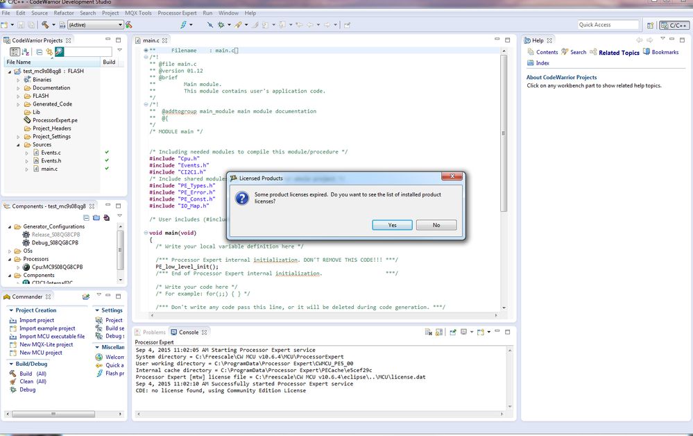

How do I prevent this pop up when starting Code Warrior 10.6?  The evaluation version was initially installed.  It has since auto down graded to the "community version".

Hi Ron,
Simply rename the file <install>\MCU\license.dat to a different name so it is not found.
I hope this helps,
Erich

Yes, that did the trick,  thanks !
