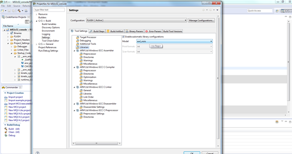

Hey,
I created a project for MKL02Z32 with IO Support and PE . The project size is Appr 6KB and without IO support is 1.5KB , How can I remove IO support from existing project?
Thanks for your help.
David

Hello David,
My configuration is CW for MCU v10.6.4 + patches (10.6.5 update).
Based on this tool I've created 3 projects for KL02Z32 device:
    - UART,
    - Console,
    - No IO.
What are the differences ?
    the library used/linked to the project
By default when you select NO IO, the ewl_noio lib is selected.
The Console is using ewl_hosted.
If you change it to ewl-noio, you will get same config than No IO.
Pascal

davidra7
Hey Pascal ,
the difference is in code size at the begining .
Thanks for the help but where I need to change it ?
David
3,199 Views
trytohelp
David,
in the project properties.
Pascal

davidra7
Thanks!!
David
