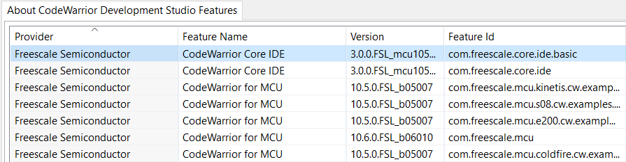

TICS_Fiona
Hello Barak
Could you supply the CodeWarrior version you are using?  To get it, please:
1)Start the IDE and click on Help | About Freescale(Metrowerks) CodeWarrior.
2)Click on Installed Products
3)Provide us all info displayed. Or you can save them in a txt file.
And what is the part number of your MCU?
Best Regards
Fiona Kuang
TIC - Technical Information Center
4,892 Views
barakmanos
Hi Kuang
Thank you for your quick response.
I am using CodeWarrior Development Studio, Version 10.6, Build Id 140329:
And I am using MC13234 (registers SDIDH/SDIDL = 0x2044).
Thanks :smileyhappy:
