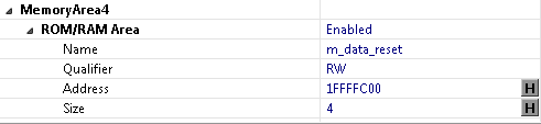

I need to exclude an array from being initialized during boot. Therefore I added a new memory section "m_data_reset" in processor expert:
And mapped this array into my new section:

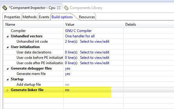

The only possible solution I've found up to know is to prevent processor expert to generate the linker file at all and to maintain it manually.

The .romp is used by the linker for the ‘copy-down’ and initialization of .data.
if you want customize your own linker file, set "Generate linker file" as "no", thus the linker file will not be overwritten by processor expert.
