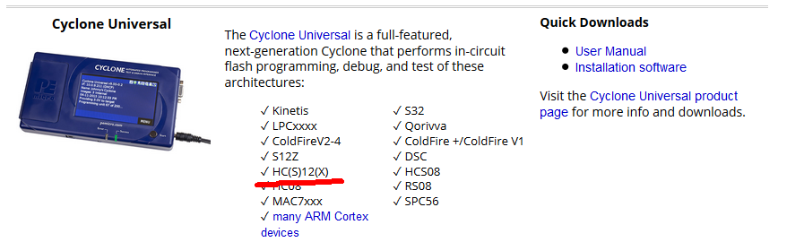

rajkumarvinodka
Hello Alice,
1- We use MC9S12DG128CPVE. You have listed MC9S12DGBCPV. What’s the difference?
2- I am not able to find the exact part we use (MC9S12DG128CPVE), the project option provides for BCPV that you have listed. How to get the option for the part we use (the MC9S12DG128CPVE)?
3- Wil CW 5.1 support USB Multilink Universal and the CYCLONE_UNIVERSAL programmers? Do these programmers support the part we use? Or is there any specific programmer/debugger you recommend?
Vinod
7,083件の閲覧回数
Hello Vinod,
- The chip of MC9S12DGBCPV , the "B" is enhance version , your chip can also
use this too. the PV is meaning 112LQFP , the PVE is lead-free 112LQFP, they are the same .
So when you create project on CW5.1 ,please select
-  Yes , they are all support the chip , you can find on the PEmicro site :
P&E Microcomputer Systems: Over 30 years as an Industry leader in Embedded Systems Development Tools...
Hope it helps
Alice
