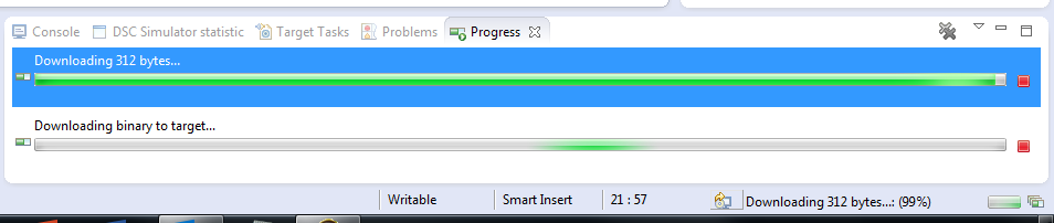

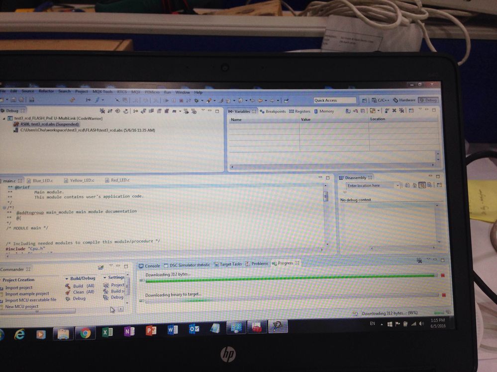

Hi all,
I had connected all pins of the flatband cable to the BDM port of my board, hence the yellow LED and blue LED on the USB Multilink has turn ON.
Currently, I am using the chip processor of MC9RS08KB12, CodeWarrior 10.6.4 and USB Multilink interface to debug my code.
But, I am facing a problem on the debugging loading time. It keep showing "Downloading 312 bytes (99%)....." without completing it. Its take up the times much more longer than the usual debugging.
Does anyone encounter this situation before ? Anyone has any experience on this which can share to me ?
Hope to hear from you guys soon. Your feedback is much appreciated.
Thank you.
724 Views
ZhangJennie
first we need identify the problem in hardware side, CW side, or specific project side.
can you please test:
1. create a new workspace
2. create a new project with wizard in this new workspace,
3. test if you can download the project to target without problem?
Jennie Zhang
