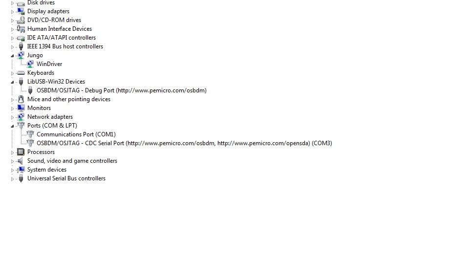

tektronix
Something weird happened with me. I tried burning to flash the code was burnt sucessfully but now when i try to again connect to the board it says cannot enter in background mode. Can you please help me with that?
I read your blod too but that did not help
6,140 Views
trytohelp
Do you reproduce the problem with a sample project created with the project wizard for your hardware config (Board+interface) ?
The example project will include all default settings.
With this example you should be able to load and flash the application using the debug, Flash File to Target, etc ...
If this example is running fine, this means you've a problem with your project else it could be a hardware problem.
Pascal

tektronix
Hello Pascal
It is hardware problem I erased Sensorship information that was the cause of this behaviour.

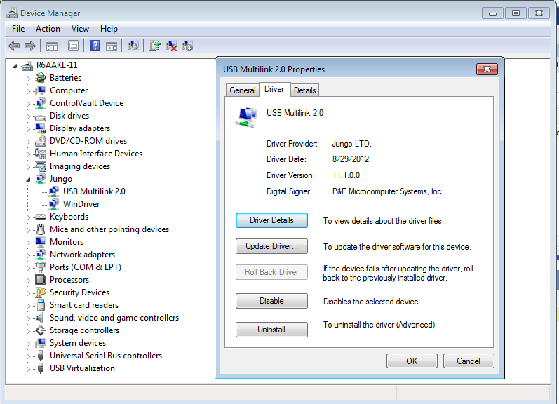

Jorge_Gonzalez
Hello Tom:
What target MCU are you trying to program?
What debugging probe are you using, Multilink, Universal Multilink, FX, OSBDM?
If the same setup works with CW10.3, then it sounds to me like the problem might be the drivers.
Please check the next link, especially the post marked as "Correct answer" from tom_thompson:
BDM multilink does not communicate with target board
Next blog could also be useful for you from MCU on Eclipse blog by Erich Styger:
http://mcuoneclipse.com/2012/10/12/fixing-the-usb-drivers/
Hope this helps. If not please provide more details.
Regards!

cavebiker
Contributor V
Thanks a ton Jorge for the rapid response.
My target MCU is a Kinetics K20DX
I am using a PE Micro MultiLink universal
I tried downloading new P&E Multilink drivers as the link you provided suggests, I followed all the procedures in the link. It still acts the same and does not work
Thanks again :smileyplain:
Tom

Rick_Li
hi Tom,
can you please try to update your driver by following the below steps:
1) connect your P&E Multilink to PC and then right click "My Computer" icon from desktop to launch System Properties, then -> Device Manager
2) Expand item 'Jungo', right click USB Multilink 2.0 (should be this name) to Uninstall it.
3) re-connect your P&E Multilink and let the PC install the software automatically.
4) follow the instruction and select USB Multilink 2.0 11.1.0.0...oem116.inf to install.
if the above does not help, then, I would also recommend updating the firmware of Multilink.
the updater can be get from below link:
P&E Microcomputer Systems
please select "Kinetis" for  "3. select Architecture to support" to upate.
hope it helps!

cavebiker
Contributor V
That did it, I'm In!
I guess what I didn't do was un-install the USB Multilink 2.0, I just disabled it.
Thanks a ton Yong Li :smileyhappy: And thanks to all the rest for helping out also.
