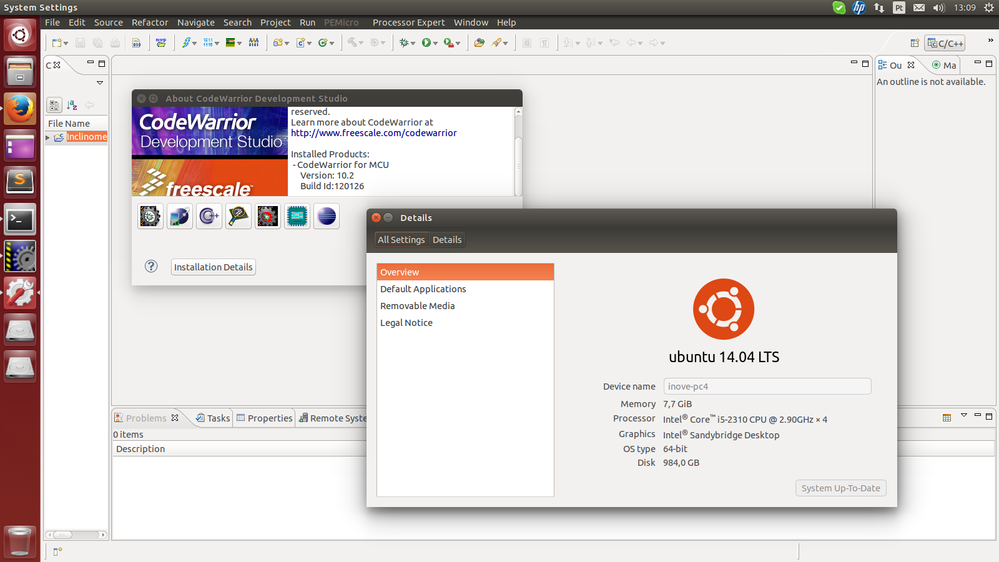

I have tried using the CW on Ubuntu 14.04 LTS 64 bits.
The installation was apparently a success.
I'm trying to program MCF51JM32 using the PEMicro Multilink Universal. Driver PemicroLinuxDrivers_2015_02_02.

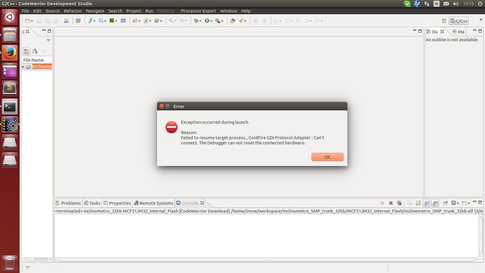

The error is seen in this screenshot.
The log console:
=== CodeWarrior GDI protocol log ===
GDI DLL: /opt/Freescale/CodeWarrior_MCU_10.2/MCU/CodeWarrior/CodeWarrior_Plugins/Debugger/Protocols/../../Support/ColdFire/gdi/cf_pne_gdi.so
CPU: MCF51JM32
GDI: DiGdiOpen()
GDI: => DI_ERR_FATAL
GDI: The Debugger can not reset the connected hardware.
GDI: DiGdiOpen()
Can anyone help me? Codewarrior for Linux has not been good. Only works on Ubuntu 10... =S

almirbraggio
The best solution: Virtualbox.
Cheers,
Almir Braggio

ZhangJennie
Hello Almir,
per CW10.2 system requirement, it can support Ubuntu 10.04 only. it wasn't tested under Ubuntu 14.04.
So officially CW10.2 doesn't support Ubuntu 14.04.
Zhang Jun
