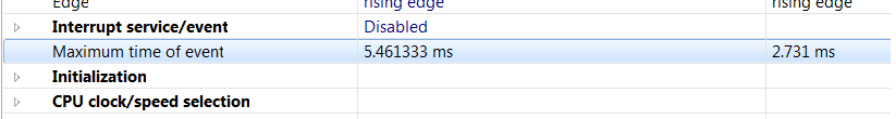

I am trying to use the Capture component in CodeWarrior. For the field "Maximum time of event", I do not understand why the value in the "Value" column is different to that in the "Details" column. Which value will be used in the code? I've put a screen shot below:

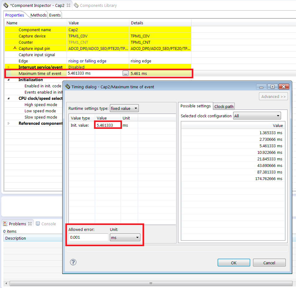

There is a problem with default settings of Allowed error in the timing dialog of the Maximum time event property. The default value of Allowed error is  5ms and therefore Processor Expert used the first value that fit the range 5.461333 +- 5ms. Therefore the value has been set to 2.731ms in the Details column. When you set Allowed error to 0.001 ms and select the 5.461333 ms in the Init. Value the same value will appear in the Details column in the Component Inspector, see the screenshot as below:

I reviewed the TMP initialization code generated by PE, and I think the value in "Details" column is the real maximum time of even used in code. When selecting the 5.461333 ms option in your project, the PS bit in TPMx_SC is configured into 0, see the code generated by PE as below:
TPM2_SC = (TPM_SC_CMOD(0x01) | TPM_SC_PS(0x00));
The modulo is initialized as 0xFFFF:
TPM2_MOD = TPM_MOD_MOD(0xFFFF);      /* Set up modulo register */
The maximum time of even should be: 65535/(24*10^6) s = 2.731ms
I have contacted PE dev. team for how to configure this option correctly, and reply you later.
