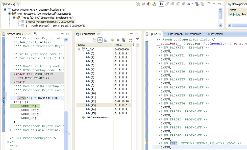

Hello Freescale Community! I'm using a FRDM-KL46Z and enabling the security flash option on the "Component Inspector - CPU". Which is the way to download the program on the board?
If I download the program with "Run", CW asks me "Device is secure. Erase to unsecure?" then I click yes and the console say:
INF: CMD>RE
INF: Initializing.
INF: Device is Secure.
INF: Device is secured. Erasing ...
INF: Target has been RESET and is active.
But the program never starts running on the board. Somebody knows why?
If I download the program with "Flash File To Target" choosing:
* The correct connection
* Flash configuration file: KL46Z256M4.xml
* The .elf of the program on file to flash
Clicking on "Erase and Program" the program downloads to the board and runs well after pressing the reset button... but when I try the attach option in debug mode, it allows me to debug as if the security flash option is disabled.

Correct, the way to download a program with security flash option enabled is throwing the "Flash File To Target" choosing:
* The .elf file of the program on "file to flash"
But! Before clicking on "Erase and Program" it's necessary "Erase Whole Device". If you don't erase the whole device it's then permitted to enter the debug mode even if the security mode is enabled.

In the document "Using the Kinetis Security and Flash Protection Features" at FSEC field description says when "FSEC[SEC] = 01" the "MCU security status is secure" then the debug mode must be disabled, but I still can get access the debug mode, somebody know why?
Please help me :-/ !

Jorge_Gonzalez
Hello Carlos Miguens:
From Processor Expert set the security bits to "00". Then use the "Flash file to target" instead of the debugger to load the .elf as you did before.
Then try to launch an "Attach" or "Connect" debug configuration. You should not be able to access the KL46.
