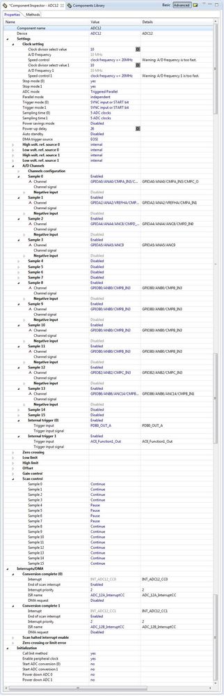

We're using ADC12 in independet parallel triggerd mode.
We want to acquire 6 samples on ADCB triggered via PDB1 (4 sync) syncing with ADC12_SCTRL in one PWM 8Khz cycle. At the end of ADC scan we want to have ADC ISR
Sample 0 -> ANB0
Sample 1 -> ANB0
Sample 2 -> ANB0
Sample 3 -> ANB0
Sample 4 -> ANB2
Sample 5 -> ANB6
PWM period 125us
PDB1 sync at 1us, 20us, 40us and 80us
ADC12_SCTRL = 0x00F0

Hello Marco
According to your PE configurations,  the samples  8~11 are got from ANB0.
Sample 8 -> ANB0
Sample 9 -> ANB0
Sample 10 -> ANB0
Sample 11 -> ANB0
Sample 12 -> ANB2
Sample 13 -> ANB6
Your intention is like below:
      PDB1 at 1us   ==> Sample 8 -> ANB0    ==> Halt
      PDB1 at 20us  ==> Sample 9 -> ANB0   ==>Halt
      PDB1 at 40us   ==>Sample 10 -> ANB0    ==>Halt
      PDB1 at 80us   ==> Sample 11 -> ANB0/ Sample 12 -> ANB2 / Sample 13 -> ANB6 ==>End
And you set the ADC work in independent triggered parallel mode. In your source code, you have configured ADC12_SCTRL as 0x00F0,  the ADCB should work as below:
      SC4  = 1 :  Sample 8  ==> Halt
      SC5 = 1 : Sample 9 ==> Halt
      SC6 =1 :  Sample 10 ==> Halt
      SC7 =1 :  Sample 11 ==> Halt

marco76
Hello Fiona
thanks for your reply!
I confirm that the samples are those ranging from 8 to 13. In my description I wrote from 0 to 5 referring to the independent group ANB.
You have correctly interpreted our needs. But unfortunately the last step does not work:
We want that:
PDB1 at 80us   ==> Sample 11 -> ANB0 / Sample 12 -> ANB2 / Sample 13 -> ANB6 ==> End
We configured ADC12_SCTRL as 0x00F0, the ADCB should word as below:
      SC6 = 1 :  Sample 10 ==> Halt
      SC7 = 1 :  Sample 11 ==> Halt
      SC12 = 0 : Sample 12 ==> Continue
      SC13 = 0 : Sample 13 ==> Continue
      SC14 = 0 : Sample 14 ==> Continue
      SC15 = 0 : Sample 15 ==> Continue
