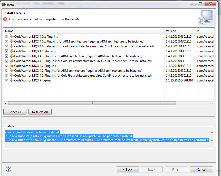

Dear Mr. Zhang,
Just selecting "MCU 10.6 Update" ( like shown in your answer ) and then Next doesn't allow me to complete the installation.
This is the full detailed explanation Codewarrior return me ( under "Details" , see also below pic ):
" Your original request has been modified.
  "CodeWarrior MQX 4.0.x Plug-ins" is already installed, so an update will be performed instead.
  "CodeWarrior MQX 4.0.x Plug-ins for ARM architecture (requires ARM architecture to be installed)" is already installed, so an update will be performed instead.
  "CodeWarrior MQX 4.1 Plug-ins" is already installed, so an update will be performed instead.
  "CodeWarrior MQX 4.1 Plug-ins for ARM architecture (requires ARM architecture to be installed)" is already installed, so an update will be performed instead.
  "CodeWarrior MQX Plug-ins" is already installed, so an update will be performed instead.
The actions required to successfully install the requested software are incompatible with the software to install.
  Cannot complete the install because one or more required items could not be found.
    Software currently installed: CodeWarrior MQX 4.0.x Plug-ins for ARM architecture (requires ARM architecture to be installed) 1.4.1.201401301129 (com.freescale.mqx.v4.0.arm.feature.group 1.4.1.201401301129)
    Missing requirement: CodeWarrior MQX 4.0.x Plug-ins for ARM architecture (requires ARM architecture to be installed) 1.4.1.201401301129 (com.freescale.mqx.v4.0.arm.feature.group 1.4.1.201401301129) requires 'com.freescale.kinetis.architecture [1.0.0,2.0.0]' but it could not be found "
Where could I find these missing pieces .. ???
5,785件の閲覧回数
ZhangJennie
in your screenshot, your CW tried to install MQX 4.0, 4.1 and 4.2, etc plugin separately.
from the message(you highlight in blue) MQX4.0 plugins are already installed. so i suggest you uncheck MQX4.0 plugins. then install MQX4.1 plugins only. see if this can work for you.
if still can't work. i would suggest you uninstall CW10.6.4 then reinstall it, then install  then follow the steps in my first response.

GottiLuca
Dear Mr. Zhang,
I've tried all the possible combinations but, at the ned, I finished to uninstall and re-install again CW10.6.4 .
Then I've made the last update "CodeWarrior for MCU v10.6.4 General Update 6" without any problems.
