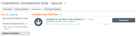

  1. Go to http://www.freescale.com/cwmcu10
  2. Click on the 'Downloads' tab
  3. Scroll down and select 'Download Options for the 'CodeWarrior Development Suite - Special':
  4. Locate the MCU v10.6.4 Update 5 under 'Updates and Patches':
  5. Download the file.

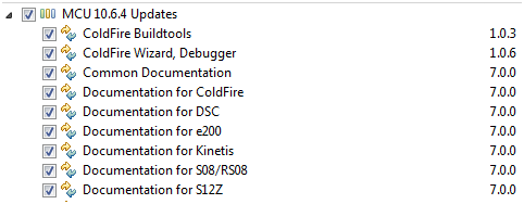

  7. Use the menu Help > Install New Software
  8. Use the downloaded zip file as local update archive: Click the 'Add...' button, then use 'Archive...' to point to the CW_MCU_v10_6_4_Update_5.zip file downloaded.
  9. Select the update(s) and go through the installation process with "Next >".
  10. Restart CodeWarrior at the end of the installation process.
