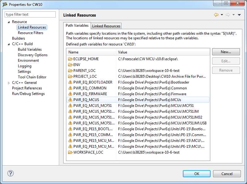

I cannot get Codewarrior to find my include files.  I have defined variables that are paths under Resource/Path Variables and I have used those to define include paths under C/C++ General/Paths and Symbols/Includes.  I did a create parser log on one include file that includes two others and it does not show any of my defined paths as search paths.  What am I doing wrong?

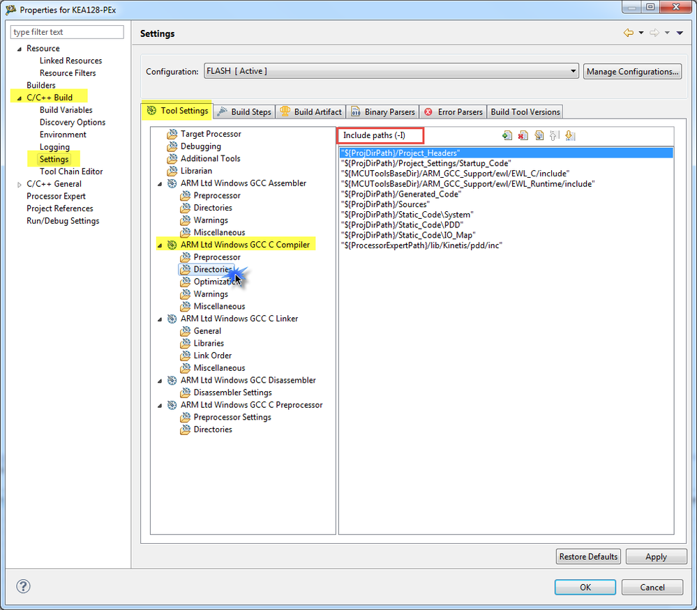

Hi Robert,
You can add your include paths by going to menu Project > Properties > C/C++ Build > Settings:
Hope it helps!

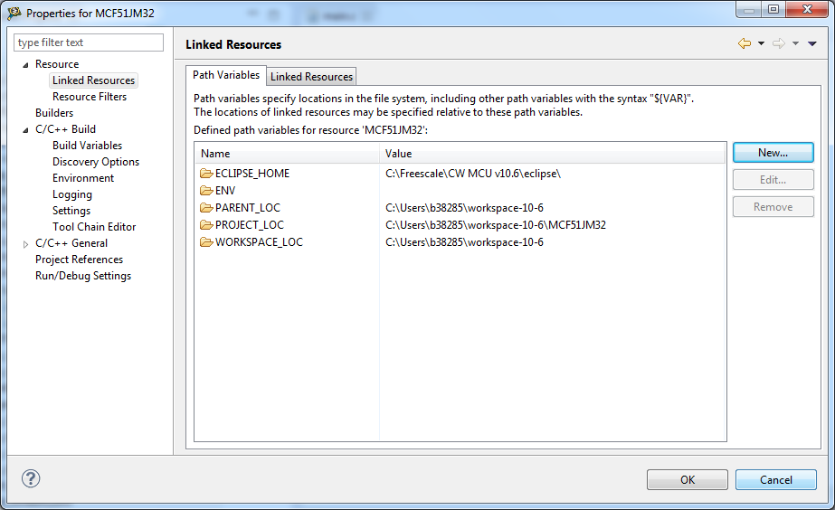

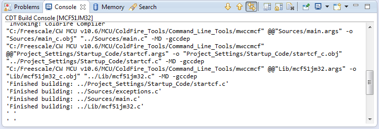

Carlos_Mendoza
Hi Robert,
Could you post an screenshot of your Path variables configurations?
It would also be helpful if you could post an screenshot of the console information you get after compiling:

R_R_Ritchey
OK, here is all the info I could figure you could use.

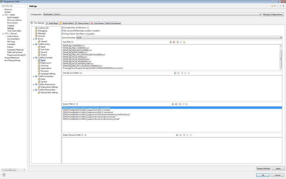

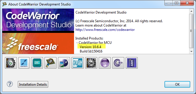

Hi, all of my drives are internal drives.  I have C, D, E, F, G & Z are all internal drives (on partitions).  I cannot move this, its tied to my Google Drive backup software.  I have no problem with Codewarrior 6.3 in this configuration (running on an XP VM) with exactly the same file structure.  I have attached a picture of my drive configuration as shown in Windows Explorer.  As far as I know I am running 10.6.4 (How do I tell if its ".4"?)  The software last updated in January. I have run other IDEs on this directory structure (including two other versions of Eclipse in separate home directories) and they have no problem with this.  This is very frustrating.  I am finding the Codewarrior Eclipse is the most picky version of Eclipse I have ever run.  Your software guys are overthinking things.
45,960 Views

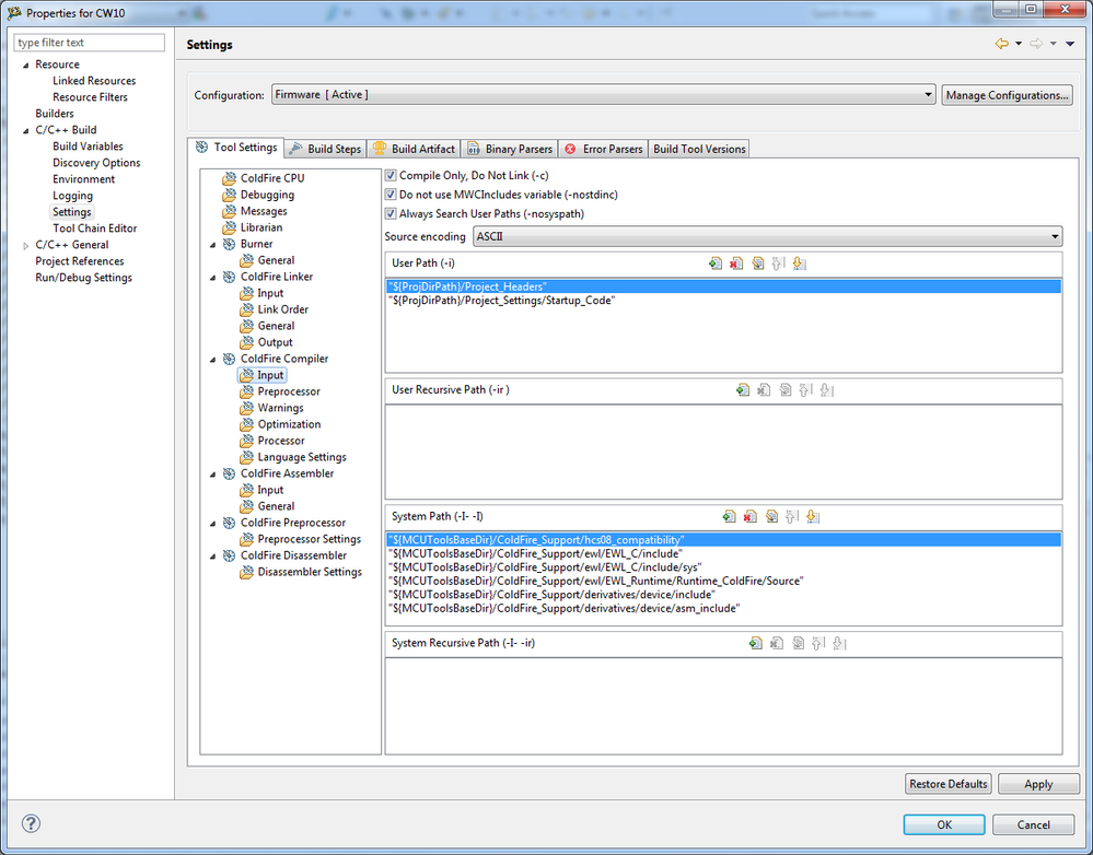

Carlos_Mendoza
Hi Robert,
Apologies for the delay.
It seems like you are using CodeWarrior 10.6, for the 10.6.4 version you should see this:
Do you get the "Unresolved inclusion" problems just when compiling the "Firmware" run configuration?
I noticed that the run configuration named "Firmware" does not have the same include paths as the "Bootloader" run configuration.
Firmware:
Bootloader:
Please try adding the Include paths to your "Firmware" configuration too and let me know if the issue is still present.

Hi Robert,
I agree with you, it can be quite time consuming to uninstall a CodeWarrior version and then make a new installation to make an update to it.
Regarding the project, I tried to run the project but notice noticed that it has no files inside the sources folder:
and it also has some linked resources which are pointing to your backup project:
You can zip the missing files and attach it here, or as I mentioned before if the project cannot be shared through the community you can send it in a case by entering a ticket NXP Technichal support.
