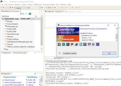

I downloaded your testing code and tried it into my CodeWarrior version. This message of error appeared when cleaning the project...
Which CodeWarrior version do you have installed? Where do you create the workspace folder?

ZhangJennie
I use  CW11.0. I think 11.1 should also work.
Build on my side again. Pass build as well.

Anemi
I finally got to clean the project with FLASH_LDM, ¿why it does not work with FLASH_SDM?

ZhangJennie
Your project doesn't include FLASH_SDM linker file. the related folder has FLASH_LDM file only.
please check the original project owner to provide SDM linker file for building FLASH_SDM configuration.
