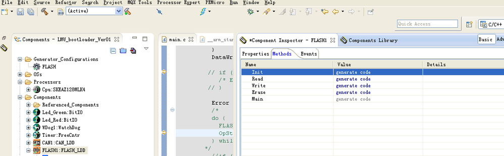

I can't find the function FLASH1_GetOperationStatus() by PE when I use the FLASH_LDD.
Could you kindly confirm this issue?
Thanks!

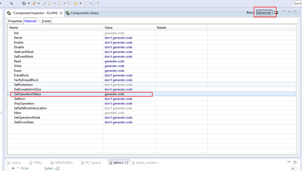

Hello Jason,
Please choose the "Advanced" , then you can find the method of "FLASH1_GetOperationStatus()" :
Hope it helps

jason_zhang
Hi Alice
Thank you very much!

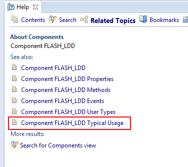

Hello Jason,
- Under the installation directory of the CW, you can find most CW DOC : \Freescale\CW MCU v10.6.4\MCU\Help\PDF
For example , the PE DOC : " ProcessorExpertHelp.pdf  " "CodeWarrior Common Features Guide.pdf" .......
- And there is a CW quick start  : Quick_Start_for_Microcontrollers.pdf (Freescale\CW MCU v10.6.4\MCU\Help),
it introduce how to create one project and how to debug.

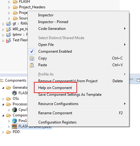

- If you use the Processor Expert (PE ) to create project , there is demo code about each component , for example the FLASH_LDD,
   please right click the component , then select "Help on Component"
then select this :
then you can find the demo code :
Hope it can helps
Alice
