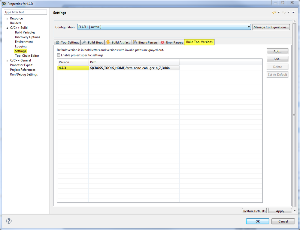

     I want to know the version of Toolchain and libraries that CodeWarrior 10.6.4 is using.
1,486 Views
ivadorazinova
Hi VIGNESH,
Version is 4.7.3
you can find it under C/C++ Build > Build Tool Versions > Version
I hope this helps.
