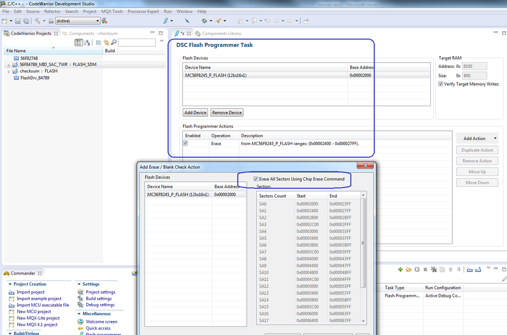

I have a MC56F8322 and I want to unsecure it via code warrior eclipe 10.6.  I only see the secure action in the flash programmer actions.  Is it possible to unsecure the device?

Hello Vincent
You can unlock the flash by mass erase operation by CodeWarrior.
In Eclipse CodeWarrior v10.6, please create a target task for DSC Flash Programmer, and add the mass erase operation, please see the screenshot as below.

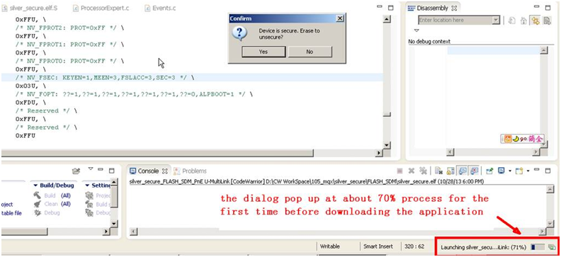

Or just download a new program into the MCU, and select ‘yes’ when debugger asks whether erase to unsecure.
