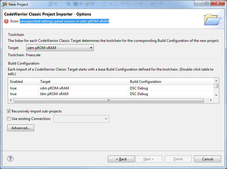

I have installed CV 10.6.4 and tried to import (file->import) a CodeWarrior 7.3 .mcp project to convert it. However, it runs into 'Error: unsupported settings panel version in sdm pROM-xRAM'. See attached. Any ideas?

Could you please first open and build your project in CodeWarrior v8.3? CodeWarrior v8.3 can be downloaded from:
CodeWarrior Development Tools for 56800/E DSC|NXP
After it can be working successfully on CW 8.3, import the CW 8.3 project into Eclipse CodeWarrior v10.6.4.
For how to do it, please refer to section 2.8 in CW10.6.4 Targeting Manual:
C:\Freescale\CW MCU v10.6\MCU\Help\PDF\Targeting_Microcontrollers.pdf
