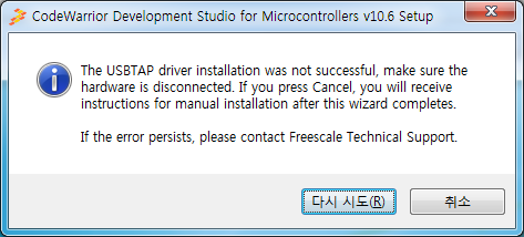

The USBTAP driver installation was not succesful
1,320件の閲覧回数
ahnjoseph
I did install codewarrior 10.6.3 (For s12zvm)
but I was not able to complete the installation.
How can i do ?
1 返信
1,210件の閲覧回数
ZhangJennie
so solve this problem, please
1. make sure you have windows admin right of the computer. it's important.
2. go to windows device manager, check if there is any USBTAP or other  board related device connected. if yes, remove the related hardware connection and driver
3. s12zvm doesn't use USB tap driver. if you can't install it. you can still use s12zvm with codewarrior. seperate driver can be downloaded from P&E web site:
https://www.pemicro.com/downloads/download_file.cfm?download_id=53
