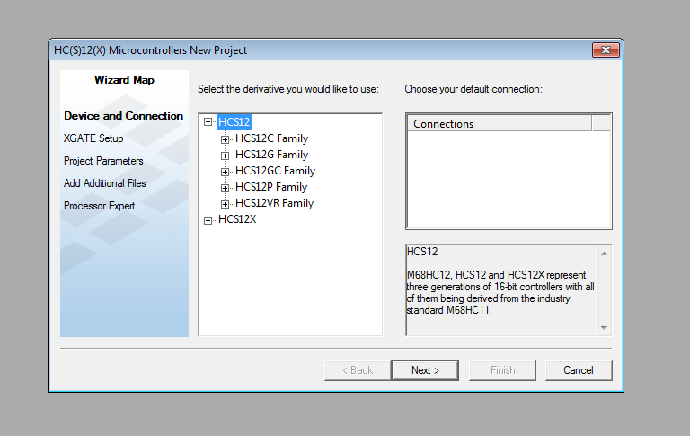

I have in my possession both a HCS08 and HC912B32 controller.

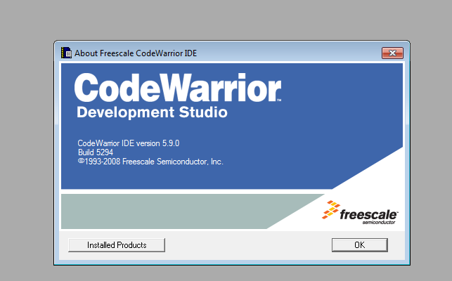

I have been using the HCS08 for some tests, but after downloading the corresponding version of CodeWarrior, v5.9.0, for the  HC912B32 controller, I do not know which family I need.

hello,
unfortunately, NXP doesn't have HC912B32 service pack. please use CW5.1 instead.
I wrote a article on this topic. see
How to install missing device to CodeWarrior for HCS12 v5.2
Hope this helps!
