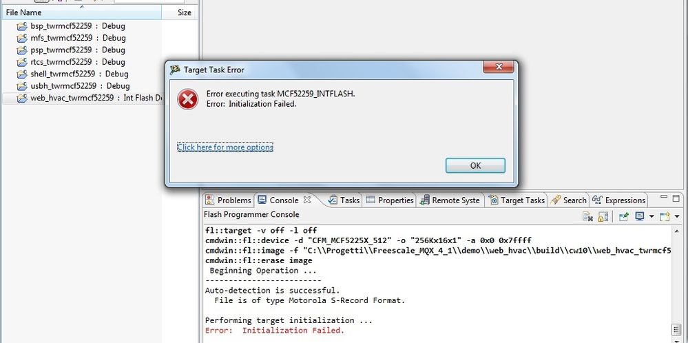

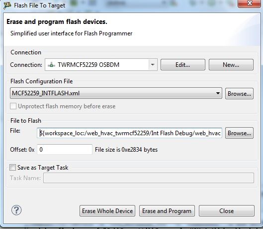

I use MQX4.1.01 with CW10.4, the micro is MCF52255. I'd like to flash the micro with the demo software "web_hvac_twrmcf52259". I want to flash by the Flash Programmer, other procedures gave me error, too.

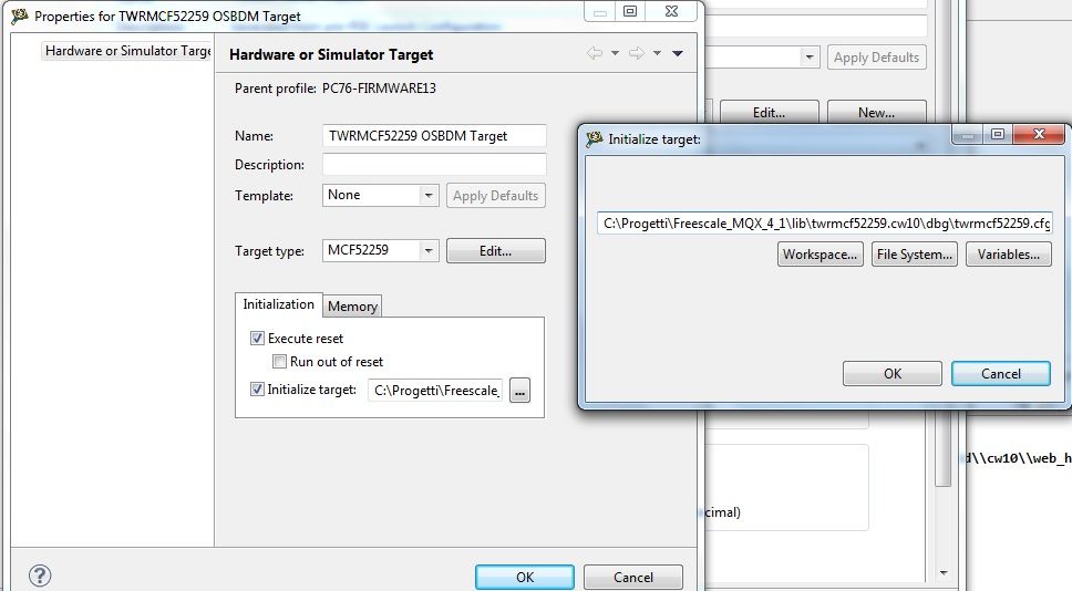

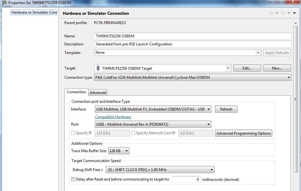

I use the PE Micro Multilink Universal. The settings are shown in the figure Settingx. When I flash the micro, I always get the error: Initializion failed.
I don't change the sourc of the libraries and the demo project.

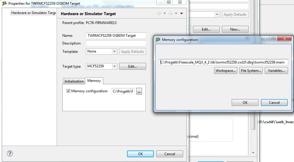

I referred to the file .cfg and .mem in the lib directory for the micro MCF5229.
Why do I get the error?

Error

I only have a 52259, so cannot verify it with a 52255. I'm using CW for MCU10.6, and here it creates the cfg and mem file for me.
I think you cannot use the 52259 files for your 52255, because the memory does not match.
So don't use the wrong files, use the ones inside/from the project:

I try to flash a my board where it is present MCF52255, so I use the configuration files of MCF52259, I don't find a configuration file MCF52255_INTFLASH.

kappa74
Hi Erych,
I found the .cfg and .mem in the CW10.4 installation directory and now the flashing is working.
