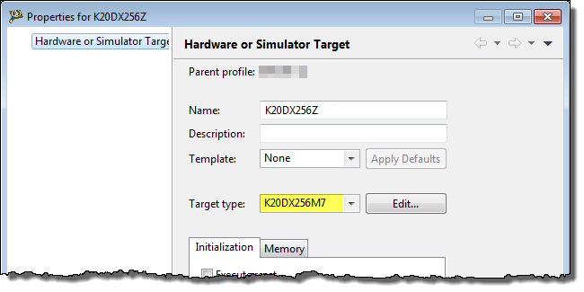

Hello, I am attempting to debug Kinetis_MK20DX256VLL7_mouse_host  in CodeWarrior 10.6 and I am getting this error "Failed to resume target process. Downloading binary to target..."
First I am asked "Device is secure. Erase to unsecure?" Then I click yes, and it gives me the message above.
In my event details I get this:
Description:
Explanation:
No details available.Details:

I have other projects that build just fine.
Any ideas where I should be looking? Thanks.

Hello Robert:
I checked that project and it seems that the target MCU is incorrect. Go to Run -> Debug Configurations -> Edit (Connection) -> Edit (Target), and in "Target type" select K20DX256M7, as in the next picture:
Regards!,
Jorge Gonzalez

BlackNight
"Failed to resume target process" means that the debugger is not able to halt/start the device, of not even able to talk to it.
Have you correctly configured if it is SWD or JTAG?
See http://mcuoneclipse.com/2014/04/20/using-the-frdm-k64f-with-codewarrior/
(section "Trouble Shooting")
The "Device is secure" message indicates that either the device is really secured (maybe accidentially), see
http://mcuoneclipse.com/2012/05/28/device-is-secure/
The debugger assumes as well that the device is secure if it cannot access it or talk to it.
That could be because either your debug cable connection is bad or wrong, or you even might have a board power issue (check that your microcontroller is properly powered).
If you can debug other projects just fine on that board, I think it really could be that this application sets the security bits, so indeed your device is secured?
