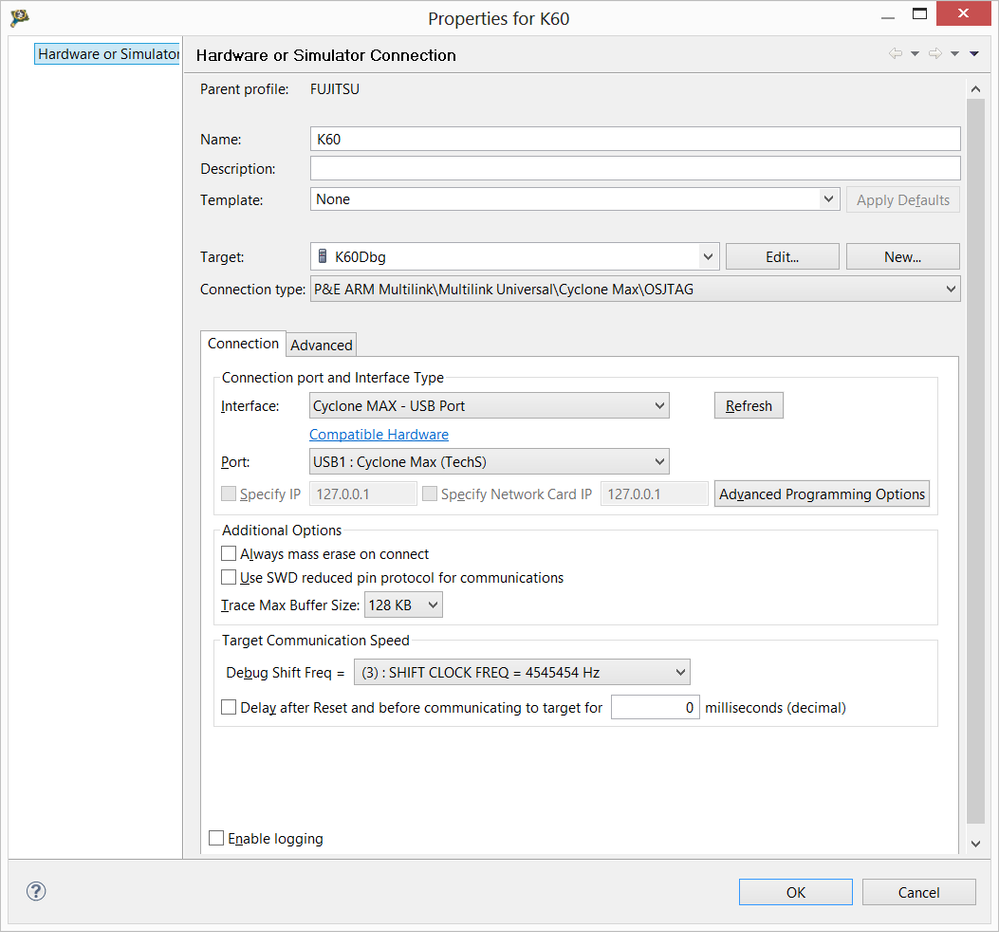

Dear Sirs,
I'm trying to use Cyclone for ARM as a debugger with CodeWarrior 10.5 and a K60 microcontroller.

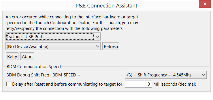

I select it in debug options but it's seen as a Cyclone MAX. Then, I start debug but at the moment of downloading firmware into K60 memory, the "P&E Connection Assistant" window tells me that there is no device available.
Any suggestion? I'll contact PE Micro too.

seems the driver problem, please uninstall cyclone max driver from windows device manager when connecting
then reinstall it.

Hi Nicola and Jennie,
Please note that the Cyclone for ARM stand alone programmer is currently NOT supported by Codewarrior. It will be supported by Codewarrior v10.6 Update 2.
Johnny
