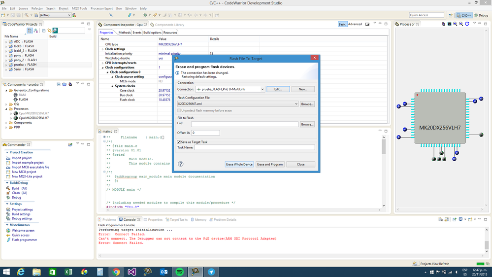

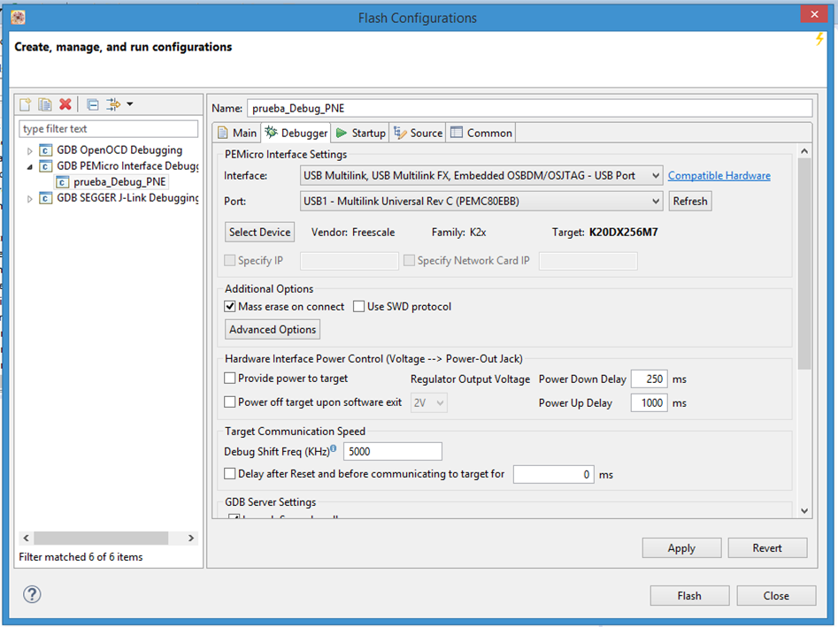

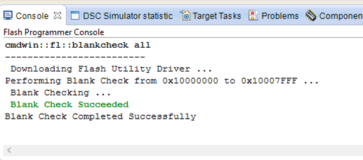

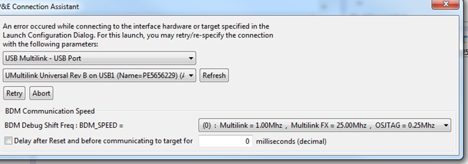

Hi everybody, I am developing my own k20 board specifically with mk20dx256vlh7, my problem is that I have already mass erased 2 chips ( first to do before debug and program), but I must have erase (and program) 4 more, I am doing same process as 2 I have already erased but without good results with 4 chips.
By reading posts and documentation I know that maybe it's a registers issue, but cartainly this is a new issue for me.

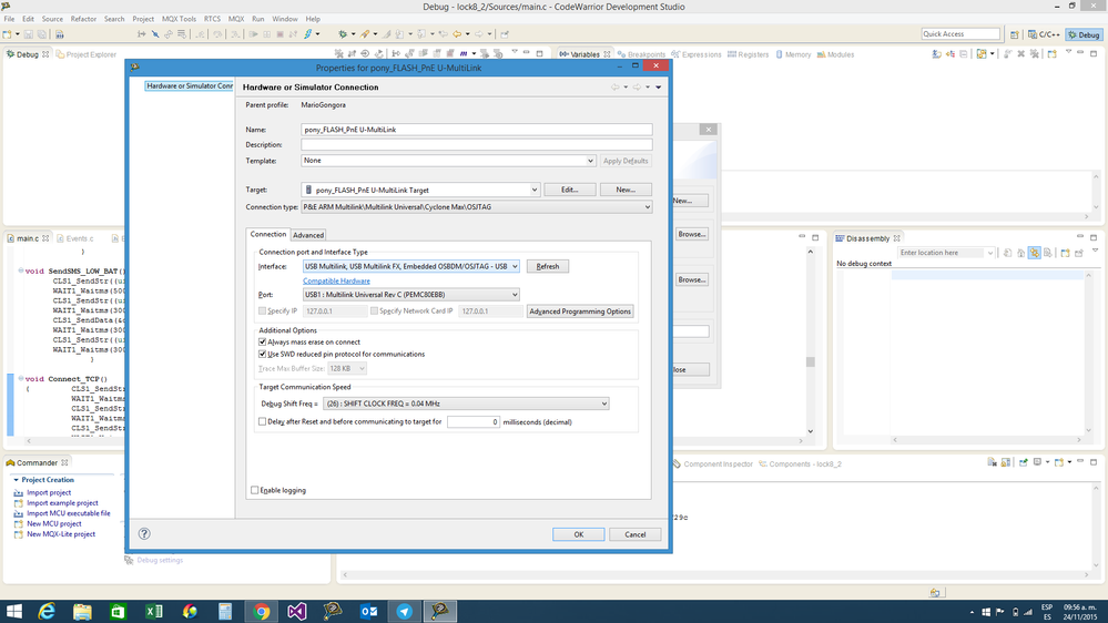

I am using PE micro multilink universal, SWD/JTAG configurations, IDE Code Warrior.
I have:
Reset_b: 10K pull up
Ez_port: 10K pull up
DIO: 10K pull up
CLK: 10K pull down + capacitor 1000pF pull down
I followed above circuit recommendations from other posts and datasheets from freescale.
I attach some print screens of my process:
I am really  concerned about this, cause I can't explain how it's possible that I have succes with 2 chips (both configurations SWD and JTAG) but no with  other.
I hope you can help me with this.
Thanks so much.

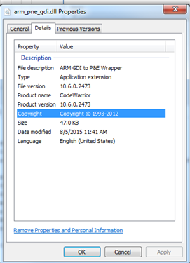

I think you're using CW for MCU v10.6.
We released several patches (updates) for this version which are:
    - Update 1.0
    - Update 2.0
    - Update 3.0
We've a problem with the Update 3.0 and Muliltink interface.
In May the MCU V10.6.4 was released.
This is not a patch but a new release and must be installed in new folder.
Please can you have a look to the link:
Problem with Multilink Rev C - not running after MCU V10.6 Update3 installed & CW for MCF V7.2
Pascal

Hi Pascal, Thanks for your response.
I am using CW for MCU v10.6.4, Multilink universal Rev C, and it works perfect to mass erase and program 2 of my k20 chips. The problem is when I try to do the same with other 4, It appears that "The Debugger can not connect to the P&E Device"
I already have installed the P&E micro update and stills working with my 2 erased chips, but no with other.
Thanks for the supporting!

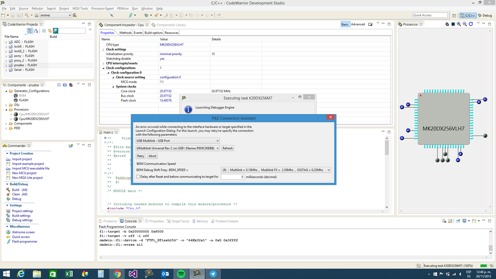

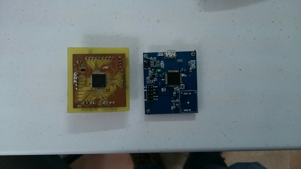

I have differents boards for each chip(6 in total), first one is a pcb hand made by myself, all others were donde by machine (exactly the same), but unfortunately just 1 works, so I can deduce circuit is ok.

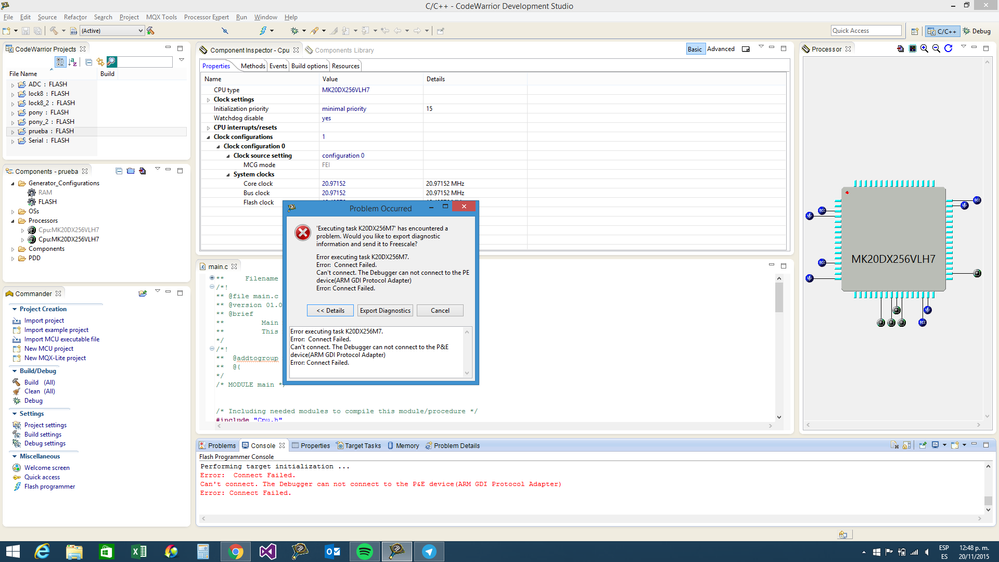

I have tried creating a New+File+ new bareboard project (no code just in blank), but stills failing.
executing flash file to target I obtain the following
Error executing task K20DX256M7.
Error:  Connect Failed.
Can't connect. The Debugger can not connect to the P&E device(ARM GDI Protocol Adapter)

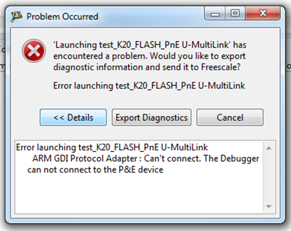

Trying to load program to the board I obtain:
Error launching prueba_2_FLASH_PnE U-MultiLink
ARM GDI Protocol Adapter : Can't connect. The Debugger can not connect to the P&E device
Keeping Multilink plugged to PC and disconnecting board I get same errors showed above.
What else can I do?
Thank you very much for your supporting.

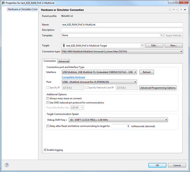

Please can you enable to log generation for P&E interface ?
Now can you try to launch debug session when the working board is plugged and when not working board is plugged.

I have tried what you comment, enabling logging, but I get same error, The debugger cannto connect to the P&E device, The problem doesn't allow even to connect with target. As you, I'm beginning to think that there is a problem with the board.
Do you have any recommendation to add, replace or remove to my circuit?

GDI: Mtwks Callback(MTWKS_CB_PROJECTACCESS, Section : STARTUP, Entry : CPUTARGETTYPENAME, Value : , R) => DI_ERR_NONFATAL
INF: P&E Interface detected - Flash Version 6.15
ERR: Can not enter background mode  .
INF: Unable to initialize PEDebug.
GDI: => DI_ERR_NONFATAL
GDI: The Debugger can not connect to the P&E device
GDI: DiGdiClose()
GDI: => DI_OK
Is there a problem with power supply ?

mariogongora
Hi Pascal,
I have tried to launch a test program to one of my working boards (firts attempt with the board plugged and second one unplugged), and I get same as you on multilink console dialog, obvoiusly when I disconnected the board, I couldn't launch it any program.
Now, trying with one of the non-working boards,
When I try to mass erase, I get following in the multilink console dialog:
=== CodeWarrior GDI protocol log ===
GDI DLL: C:\Freescale\CW MCU v10.6.4\MCU\bin\Plugins\Debugger\protocols\..\..\support\arm\gdi\arm_pne_gdi.dll
CPU: K20DX256M7

When I try to launch debug session, I get a message that device is secured:
In the console:
CPU: K20DX256M7
GDI: DiGdiOpen()
GDI: => DI_OK
GDI: DiGdiGetFeatures()
GDI: => DI_OK
GDI: Identification: ARM Cortex M4 P&E to GDI wrapper, Version: 1.0.1, MeeAvailable: true, NrCpusAvailable: 1
GDI: DiGdiAddCallBack(cb_type = 0x4000)
GDI: => DI_OK
GDI: DiGdiInitIO()
GDI: Mtwks Callback(MTWKS_CB_SETMEEID, 1) => DI_OK
INF: P&E Interface detected - Flash Version 9.33
INF: Device is Secure.
INF: Device is secured. Erasing ...
GDI: DiGdiClose()
GDI: => DI_OK
If  you notice, it appears that Device is secured, both, when I tried to mass erase and launching a debug session.

mariogongora
Hi Pascal,
I have installed KDS 3.0.0
I created a new kinetis project.
I tried to flash one of my non working boards, I get the following:

I can't connect to target.
However, I could mass erase one of my working boards succesfully:
034,005 2-gdb-version

I contacted P&E regarding the difference with the flash version we used.
Don't think if this will help but:
Have them update to the latest firmware via our firmware update tool and let me know how it goes.
They may also want to try reducing the BDM shift frequency as this might be an communication issue since the older Multilinks are a lot slower.
Pascal

Ok, I will update the firmaware and check it.
Btw I have same details as you
C:\Freescale\CW MCU v10.6.4\MCU\bin\plugins\support\ARM\gdi
I'll inform you in a while how it goes with the updated firmware.
Thank you.
Mario

mariogongora
Hi Vicente,
I have changed a chip from one of my nonworking boards to one of my working board, I couldn't mass erase or debug it,
This week, I am doing a new board, I will put a new k20 chip, and I will try to debug it.
Do you think there is a problem with the MCU?
Thanks.
Mario

mariogongora
Hi Vicente,
Yes you are right, I am using a board that works prevoiusly with a chip removed from other board that didn't work.
I have re-checked and cleaning my board,  MCU is ok, VDD's GND's, JTAG/SWD Pins.
I cannot connect to the device.
On the reset pin I have 0V all the time, even when I try to mass erase or debug the MCU.
I have:
DIO: 10K pull up
CLK: 10K pull down
What else can I try?
Thank you.
Mario

mariogongora
Hi Vicente, I'm sorry for the late response, I was not in the office to do more testing.
I removed the pull up on Ez_port and pulldown on CLK, I still can't connect to the target.
I swapped the microcontroller (to check if my boards were the problem) from a non-working board to a working board, but without success.
Finally I made two new boards, one of them works perfectly but the other didn't, I am using same circuit for both.
I think there is a random problem with the chips, some of them are secured and I can't mass erase them or debug them.
Since we're in a hurry and need to finish the project as soon as possible we changed the microcontrollers but if you can find something about this problem I would like you to let me know, because in the near future I'd like to use this microcontroller for other projects.
Regards.
