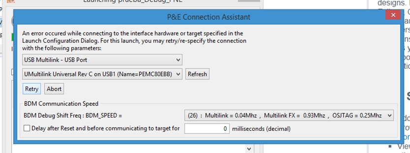

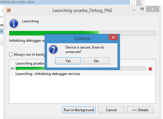

Hi everybody, I am developing my own k20 board specifically with mk20dx256vlh7, my problem is that I have already mass erased 2 chips ( first to do before debug and program), but I must have erase (and program) 4 more, I am doing same process as 2 I have already erased but without good results with 4 chips.
By reading posts and documentation I know that maybe it's a registers issue, but cartainly this is a new issue for me.
I am using PE micro multilink universal, SWD/JTAG configurations, IDE Code Warrior.
I have:
Reset_b: 10K pull up
Ez_port: 10K pull up
DIO: 10K pull up
CLK: 10K pull down + capacitor 1000pF pull down
I followed above circuit recommendations from other posts and datasheets from freescale.
I attach some print screens of my process:
I am really  concerned about this, cause I can't explain how it's possible that I have succes with 2 chips (both configurations SWD and JTAG) but no with  other.
I hope you can help me with this.
Thanks so much.

mariogongora
Hi Pascal, Thanks for your response.
I am using CW for MCU v10.6.4, Multilink universal Rev C, and it works perfect to mass erase and program 2 of my k20 chips. The problem is when I try to do the same with other 4, It appears that "The Debugger can not connect to the P&E Device"
I already have installed the P&E micro update and stills working with my 2 erased chips, but no with other.
Thanks for the supporting!

I have differents boards for each chip(6 in total), first one is a pcb hand made by myself, all others were donde by machine (exactly the same), but unfortunately just 1 works, so I can deduce circuit is ok.
I have tried creating a New+File+ new bareboard project (no code just in blank), but stills failing.
executing flash file to target I obtain the following
Error executing task K20DX256M7.
Error:  Connect Failed.
Can't connect. The Debugger can not connect to the P&E device(ARM GDI Protocol Adapter)
Trying to load program to the board I obtain:
Error launching prueba_2_FLASH_PnE U-MultiLink
ARM GDI Protocol Adapter : Can't connect. The Debugger can not connect to the P&E device
Keeping Multilink plugged to PC and disconnecting board I get same errors showed above.
What else can I do?
Thank you very much for your supporting.

mariogongora
Hi Pascal,
Yes, I know this is difficult and really weird, I can't find explanation about this.
I have tried what you comment, enabling logging, but I get same error, The debugger cannto connect to the P&E device, The problem doesn't allow even to connect with target. As you, I'm beginning to think that there is a problem with the board.
Do you have any recommendation to add, replace or remove to my circuit?

INF: P&E Interface detected - Flash Version 6.15
ERR: Can not enter background mode  .
INF: Unable to initialize PEDebug.
GDI: => DI_ERR_NONFATAL
GDI: The Debugger can not connect to the P&E device
GDI: DiGdiClose()
GDI: => DI_OK
Is there a problem with power supply ?

When I try to launch debug session, I get a message that device is secured:
In the console:
=== CodeWarrior GDI protocol log ===
GDI DLL: C:\Freescale\CW MCU v10.6.4\MCU\bin\Plugins\Debugger\protocols\..\..\support\arm\gdi\arm_pne_gdi.dll
CPU: K20DX256M7
GDI: DiGdiOpen()
GDI: => DI_OK
GDI: DiGdiGetFeatures()
GDI: => DI_OK
GDI: Identification: ARM Cortex M4 P&E to GDI wrapper, Version: 1.0.1, MeeAvailable: true, NrCpusAvailable: 1
GDI: DiGdiAddCallBack(cb_type = 0x4000)
GDI: => DI_OK
GDI: DiGdiInitIO()
GDI: Mtwks Callback(MTWKS_CB_SETMEEID, 1) => DI_OK
GDI: Mtwks Callback(MTWKS_CB_PROJECTACCESS, Section : STARTUP, Entry : CPUTARGETTYPENAME, Value : , R) => DI_ERR_NONFATAL
INF: P&E Interface detected - Flash Version 9.33
INF: Device is Secure.
INF: Device is secured. Erasing ...
GDI: DiGdiClose()
GDI: => DI_OK
If  you notice, it appears that Device is secured, both, when I tried to mass erase and launching a debug session.
I have checked power supply in my non-working boards, everything is correct, I have 3.3 V, and the yellow led on the multilink tool lights.

Also, I can launch example program I have created.
I have a question, If devices are secured? All of them are secured at the beginning?
If no, I think I have good luck with 2 of my chips but no the same with others 4.
I re-checked (again) my connections, and everything is ok, the circuit is in the same conditions that my working boards.
Sorry for too long text,
Thank you Pascal.
Mario

Pascal, Vicente:
Aftrer update the firmware I tried flash file to target , problem stills appear with non-working boards, even I try with a new board, new chip (same circuit), but no good results. Also I change the BDM shift frequency, I use (9) and (26).
Working boards go ahead without problems after updating and even change BDM shift frequency.
I think after doing all these tests, as Vicente comments, I will swap a functional chip to one non-working board and try to flash and launch program.
I was reading that first you have to do before launch a program is to mass erase the MCU.
mass erase means to unsecure the MCU?
It's possible that 2 of my chips came already unsecured from factory?
I will do the swap and let you know what happens.
Thank you for your support.
Mario.
