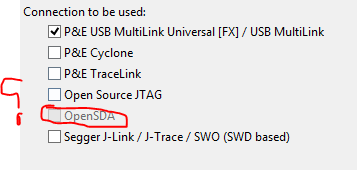

Hi everyone,
i am trying to create a project in CW 10.6 with the FRDM board K22F-120Mhz, but in the connections window doesn't appear the OpenSDA option, what means this?, beacuse i already installed the firmware to the openSDA at the frdm, and  i have been working properly with the FRDM KL25Z and this board works good. , or, i am forced to use the Kinetis design studio to work with the K22F frdm board??,
Can somebody help me please??
i am not shure which of these MCU i must select, but however any of the boards haven't the option openSDA..

Hello Alonso:
CodeWarrior does not support K22FN512 as the one in FRDM-K22F. You have to use KDS or a third-party IDE: IDEs for Kinetis MCUs|Freescale.
Those K22 devices you see are legacy K22_120 parts, that is why those are still supported by CW. More details here: Kinetis K22_120 MHz devices.
