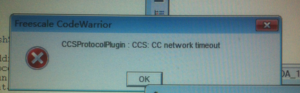

    I use USBTAP ONCE to connect 8037 board, when I debug, the following error.21434_21434.png2015-03-26_091443.png
I use IDE Codewarrior V8.3 . My OS is  windows 7.

CodeWarrior 8.3 was released before Windows 7, it is not verified on Windows 7.
However, we have tested that its build tools work well on Windows 7, only debugger does not work well, below is the solution to work it around:
To support USBTAP debugging on Windows 7, user needs to install the new CCS update, please search 'AN4338' on Freescale's website (www.freescale.com), and follow the instructions in it to install the update.
