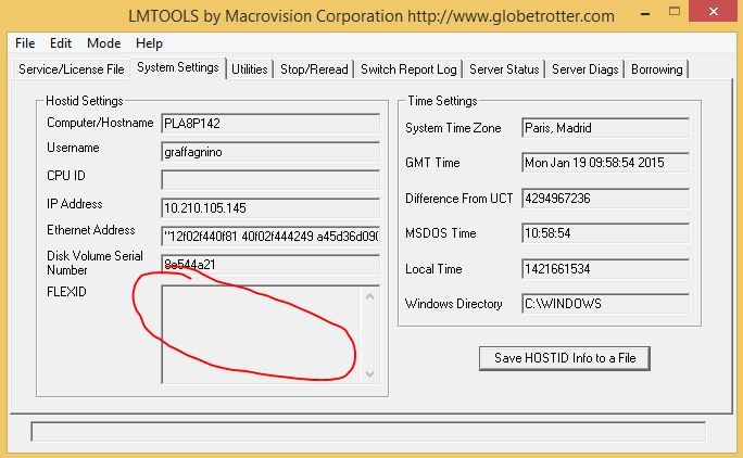

For information, I already install HASP driver v6.65 from sentinel software with success.
But when I want to read the dongle number with FLEXLm licence manager, there is no id of the dongle :Capture.JPG.jpg
Thank you for your help.
Regards.
Rémy
14,886 Views
trytohelp
Remy,
Attached the avi version.
On my side I've the 6.65.0.0 version too.
To download the driver and Flexlm you can go to:
          USB Dongle Drivers|Freescale
Download the lmtools for Windows (32-bit) and not the lmtools for Windows (64-bit)
It seems there is a problem with the 64bit file.
The 32bit is running fine on my side too (Win 8 64 bit).
Pascal
Freescale Technical Support
14,886 Views
graffagninoremy
Ok Pascal, with the 32 bit it works.
The FLEXID is now visible.

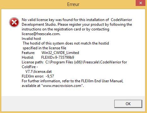

Other problem now, Codewarrior IDE does not recognize the dongle or license file.
Before I just make a copy of the "license.dat" file previoulsly installed on the old laptop under windows VISTA.
Can you help me ?
14,886 Views

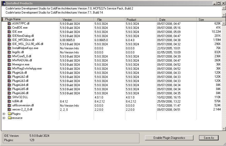

In the picture below, the products installed on the VISTA laptop :
Regards.
Rémy
14,886 Views
trytohelp
Hi Remy,
This is the problem.
CW for Coldfire V7.1 was designed for XP 32 bit OS only.
To support the 64 bit we introduced a new USBDongle driver.
However this driver is not compatible with older version.
This is the case for CW for Coldfire V7.1.
Why ?
Products built with 8.4a of Flexlm (i.e. All of the classic products) will not be able to support win 7 64-bit with USB dongle licensing.
That support was added in 11.4 of Flexlm and our eclipse products moved to 11.5.
This is true for all 64 bit OS.
I've performed some tests under Win 7 64bit and Coldfire V7.1.
The USBdongle can not be used with this config.
You can not use an USBDongle license for Coldfire V7.1 under 64 bit OS.
We recommend you to rehost your license to DiskID.
Other solutions are:
      - Keep XP machine,
      - use last version based on Eclipse MCU V10.6.
            This could have an impact for your development because you need to move the project from V7.1 to MCU v10.6.
Pascal
14,886 Views

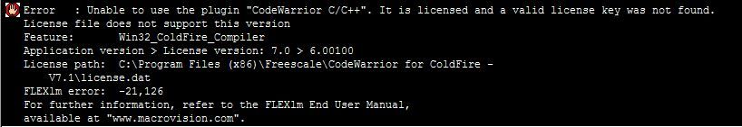

Problem in CW Coldfire V7.1 after trying to compile :
Regards.
Rémy
14,886 Views
trytohelp
Remy,
I think we should continue via a SR.
Please can you report the problem to [email protected] ?
I'm working at support team.
      You can put my name or  To Pascal ...
It will be more confidential to exchange information as license file.
Pascal
14,886 Views

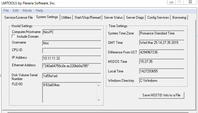

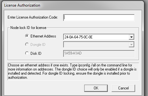

francky
Hello Pascal,
i have problem with Dongle too. But at the difference with Remy i can see in FlexID
but in license authorization, i can't find the dongle ID.
I'm new in the company. And we have 3 USB dongle, one is correctly running in other Pc with same characteristic (Win7, 32 bit). we have CW 4.5.
What you suggest me to do?
Thank you.
regards,
14,886 Views
trytohelp
Hi Francisco,
Don't think it's the same problem than Remy.
I recommend you to create a new post for this question.
Keep i mind the License Authorization is not used anymore to manage license file.
Don't use it.
Please provide us more info regarding the tool version you're using.
Do you used Windows 8 too ?
Pascal
14,886 Views
