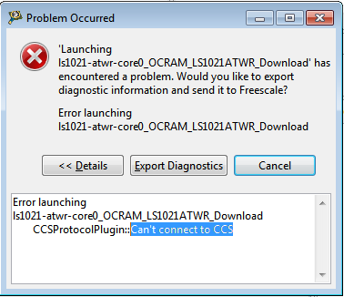

I have a problem when I'm trying to start the debugger on CodeWarrior:

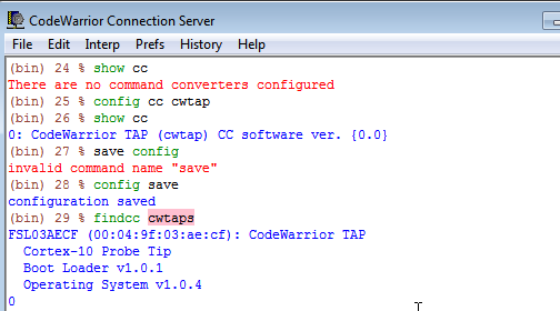

The problem is, when i'm trying to launch ccs.exe manually, it can detect the probe:
I've looked into this: Can't connect CCS
and specifically:
I've tried writing these commands, and I don't have the same output, so I must think there might be some target connection error.
Here is my output:

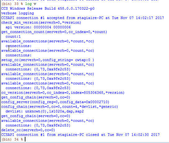

Here is what happens when I launch the debugger from CodeWarrior:
With log v :
It seems like a connection has been established and then immediatly closed.

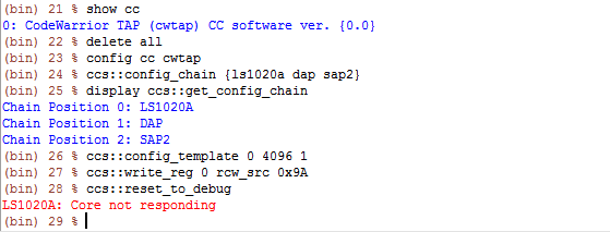

This is the output I received:
Note: After I do ccs::reset_to_debug, the D5 led turns itself off.
Filip

addiyi
It could be because of missing RCW.
Try the followings:
delete all
config cc cwtap
ccs::config_chain {ls1020a dap sap2}
display ccs::get_config_chain
ccs::config_template 0 4096 1
ccs::write_reg 0 rcw_src 0x9A
ccs::reset_to_debug
Provide the output.
Adrian

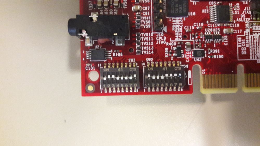

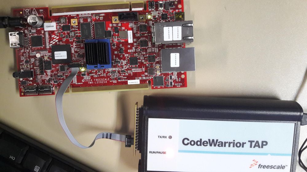

This is my montage:
Note that the D5 led near the boards's jtag pins is always on, as opposed in the Getting Started Documentation I mentioned above.
The RUN/PAUSE Led is always on and orange
and the TX/RX is blinking in a green color (The picture I Took is in between the blinks)
And these are my switches configuration (It's the default configuration as in the Documentation) :
What can I do at this point ? The entire NOR flash of the board has been erased, that's why we've been trying to re-flash it with QorIQ 2.0 SDK included NOR Flash.bin on CodeWarrior.

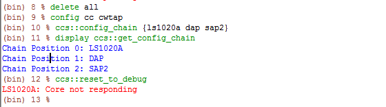

filipjabin
The output for both commands is the same:
LS1020A: Core Not responding
Does that mean that it's the connection between the probe and my target ?

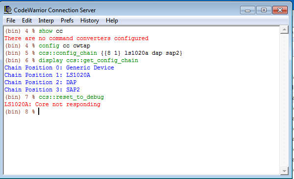

addiyi

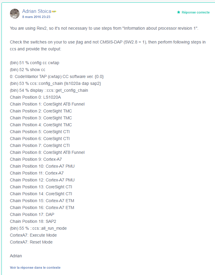

Can you try the followings commands in ccs:
config cc cwtap
ccs::config_chain {{8 1} ls1020a dap sap2}
ccs::reset_to_debug
after that:
delete all
config cc cwtap
ccs::reset_to_debug
Provide the output.
Adrian
